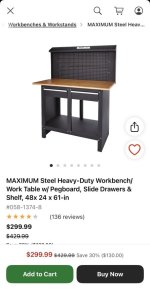

Lot's of steel frame benches on Amazon, but I wonder if they would jiggle about too much.
