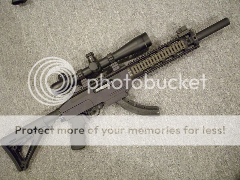

And so I don't get in trouble for hi-jacking the thread, I'll post a pic of my 10/22 with its ATI Dragunov styled stock. It's lightweight, looks good (to me, anyway) and it allows me to mount the scope really low. I find the AR-15 styled stocks make it impossible to mount the scope any lower than 3" to the bore (2.5" at best) and still get a good cheek weld. In MY opinion, (which counts for nothing BTW) given the .22s lousy ballistic qualities, a low mounted scope is crucial unless all you're doing is shooting paper targets at fixed ranges.
Cheers! :)
