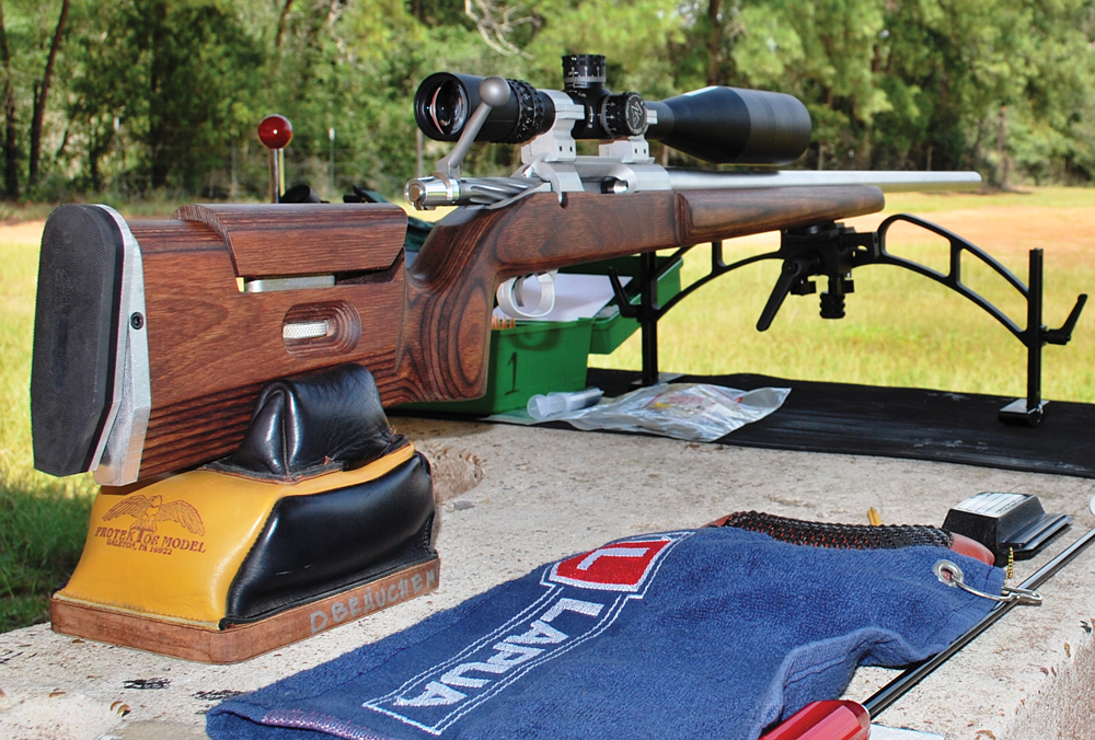

F-Class:
-shot off a bipod or a machine rest
-all shooting from the prone position
-only one distance is shot at a time, its a known distance evenly divisible by 100
-targets are paper circular targets
-lots of time to make your shot (deliberate shooting)
-there are wind flags
-targets are always stationary
-shooting is always horizontal (no slope shooting)
-each shot is marked with an orange marker to show you where it went
-shot individually
-course of fire is always the same
