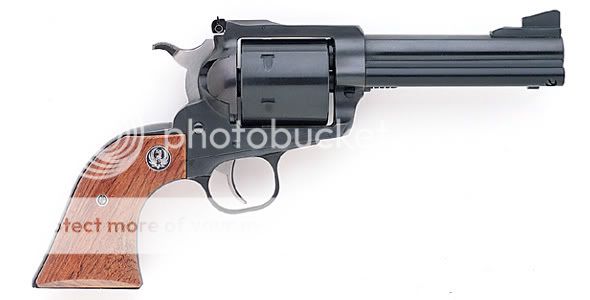

Do you mean like the new models like this?

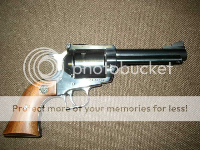

Or do you mean an older model like this one of mine?
I like the rounded trigger guard on the new models, but will likely buy another old one with a longer barrel and have it cut down again - if its cheap enough, otherwise may as well just buy a new shorty - maybe a stainless one this time.
