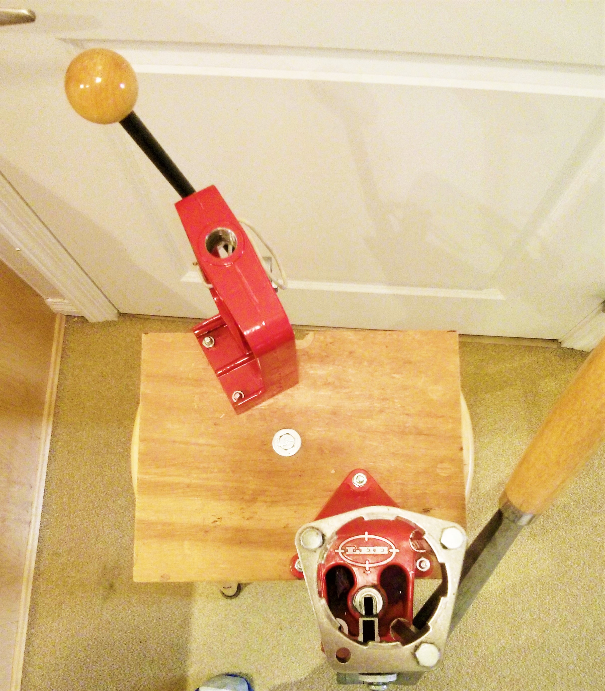

I have two Lee presses mounted on a bar stool with a 1/2" piece of plywood for strength.
Either press can be used by turning the stool around.
Then any table or flat surface can be used for for the scale, powder, etc.,
I would post a picture but for the CGN picture system.

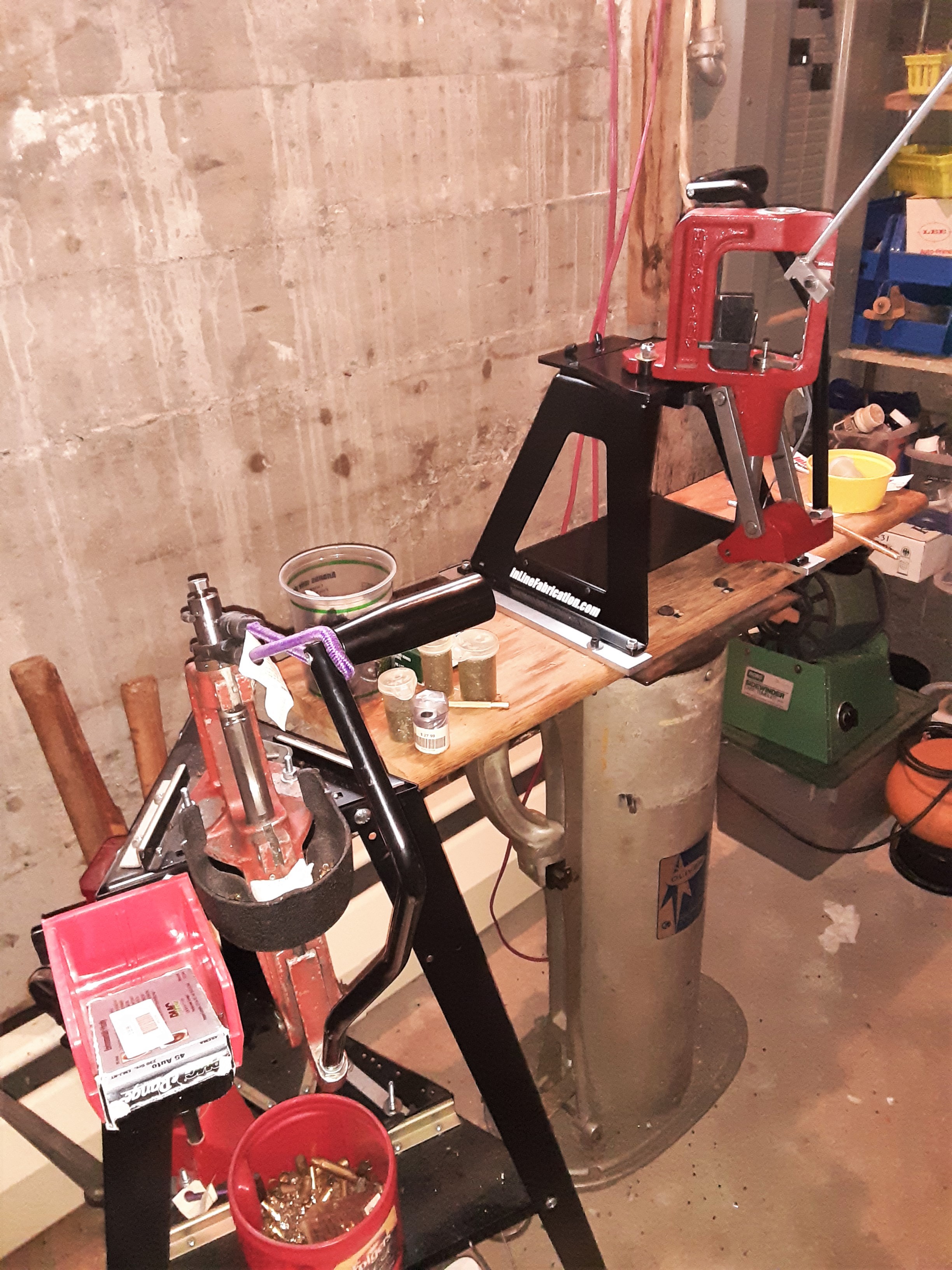

you could get one of the reloading lee stands. not sure not if its compatible with other types of presses but I think it would be worth looking into.

I kind of did my own thing trying to mimic the Lee stand. Cut a hole in the surface for the open frame press and mounted a glass jar by it's lid to capture the primers. This is standing height as well and wider at the base than the picture leads a person to believe. I wanted to move around a bit with some of the repetitive reloading actions.
Regards
Ronr
