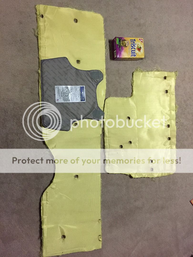

Tested a bunch of mine out so far.
Results:
BB gun - not even 1 layer
175lb crossbow with field tip - small hole in 6 layers
22lr from 10/22 - 3 to 5 layers
7.62 x 39 steel core from Sks - penetrated 138 layers and continued on
7.62 x 39 steel core from Sks - 3/8" of polycarbonate and 135 layers of Kevlar stopped the round.
5.56 x 45 62gr tulammo from T97 - penetrated 3/8" polycarbonate and 138 layers of Kevlar and continued on
