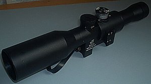

:confused: Hi, i know some people may find this weird or dumb but would it be possible to put an original svd dragunov sniper scope on a svt-40? (without big modifications...?)

It can be done with POSP mount/dragunov/ak type. I never done it but Russian sites and dealers claim that POSP Dragunov mount will fit on SVT. Personaly I think The reciver walls are too thin same situation as CZ 858 you will have to add a bracket to strenghten the reciver wall
anyway i would get one of these
and one of these
its a posp 8x42 from east wave (Canadian importers .....about 188) but it mounts conventionally
the result is you get a soviet rifle soviet scope that you can change back and not wreck the historic integrity of your rifle ......now if only there was replacement stocks
