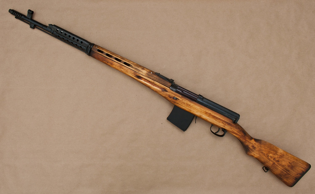

The wood is beautiful on that rifle ^^^^^
I like the way the wood seems to be coloured so that it fades to black where it meets metal. Also the overall colour is great!
Mine is an orange-ish colour also, but not as good looking as that one. Where did you get the OP get such a great looking SVT-40?
