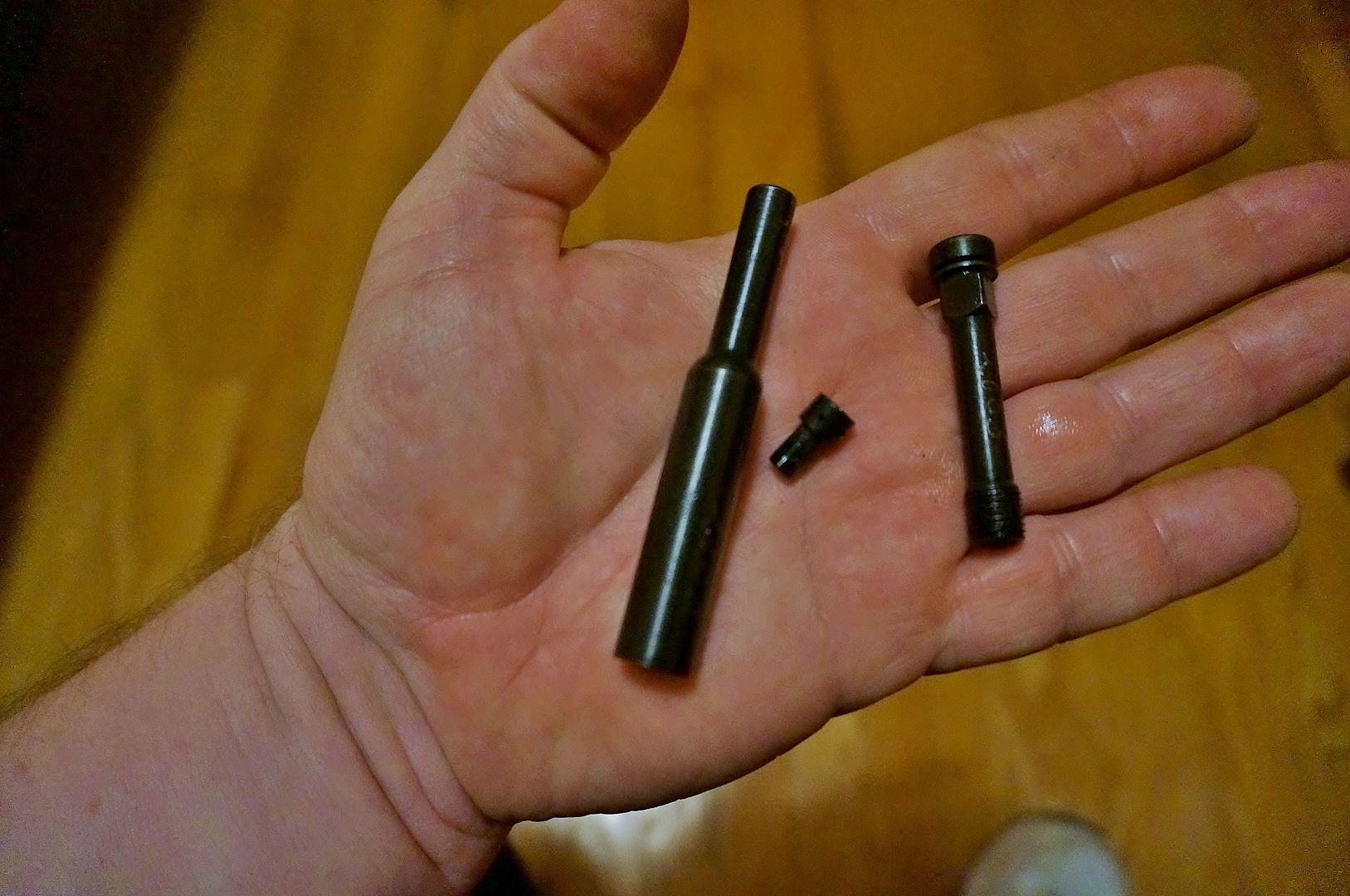

Issue as in the cylinder and gas piston were seized solid, along with the gas system adjuster. Was doing a complete dissasembly (haven't shot it yet) just to have a good look at everything first, along with becoming more familiar with the rifle. Everything is fine, except those gas system components; started this teardown a couple days back and so I soaked those frozen components in WD-40 Rust Release Penetrant and this evening, after some persuasion, it's all now apart. Didn't beat on anything just kept working at it until it started to give a little, then more soaking and sitting, until finally it's all apart. Have cleaned it up just with solvent at this point and the parts now move again, but the movement of the piston inside the cylinder is very rough, along with the gas adjuster not wanting to move freely when back in it's housing. These parts salvageable with a little careful abrasive cleaning or just look for replacement? I think Corwin has such.
P.S. the parts in question; they don't "look" bad ie they weren't lumps of rust (and the small gas ports in the adjuster itself are clear), but they are rough to the touch.
