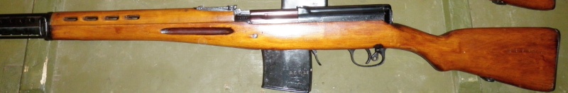

Close ups Before:
The Tools:

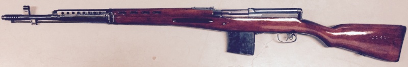

End of day results as it dries
Thankfully my wife is gone for the evening so it is ok for me to use the bathtub to dry while she is not home :)

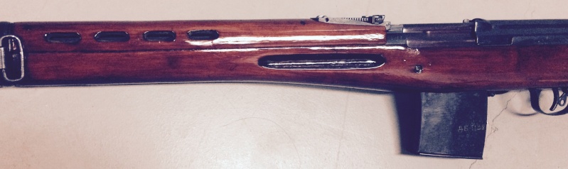

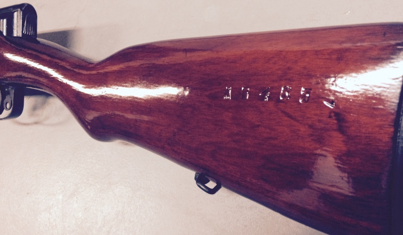

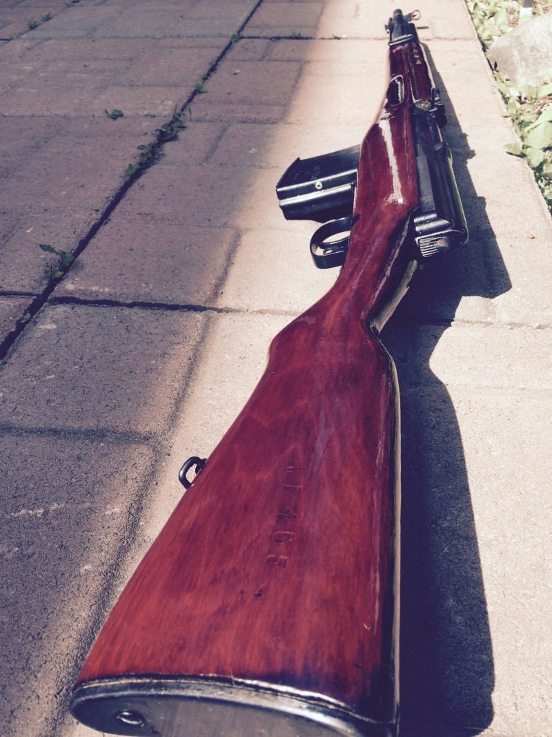

After 7 days and 7 coats
The pictures do not do the finish justice at all. I will get some better ones in the sun light. I am super thrilled
Welcome to the Red Rifle section of CGN! Wonderful character in that SVT! I have a 1941 SVT Izhevsk that is the rifle that I would most like to be good with but unfortunately, I'm the kind of guy that the SKS was designed for (small, clumsy and poorly trained) It is great that you treasure the character in your SVT, please keep those pictures coming as you progress.:wave:
Just updated my post with the finished product but the flash on my camera really ruins it. in the natural light it looks fantastic so I will try and get better pics.
