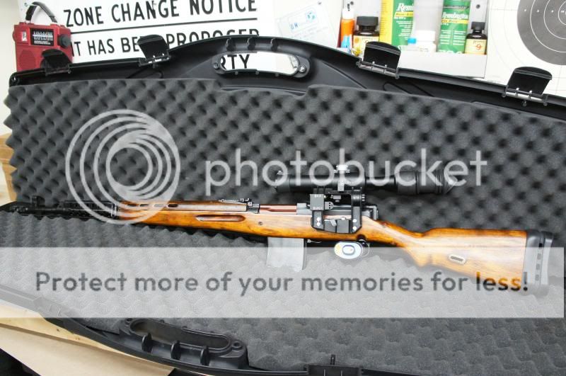

Anyway, this is how I would set this SVT up, with the Molot rail and Posp. The Posp is calibrated for 7.62x54. with range finder (great scope)

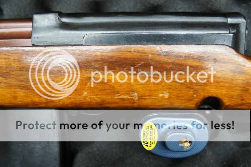

My SVT-40 has some dings as mentioned, right where the rail would mount. The dings bother me a bit, not very apparent in the pic, but the rail would cover some of the dings. The pic with the Posp on the rifle is propped up to get an idea of how it would be configured.
I'm not sold on this project. That being said it is on my mind a lot :confused:
the dings.. minor, I've seen worse.;)

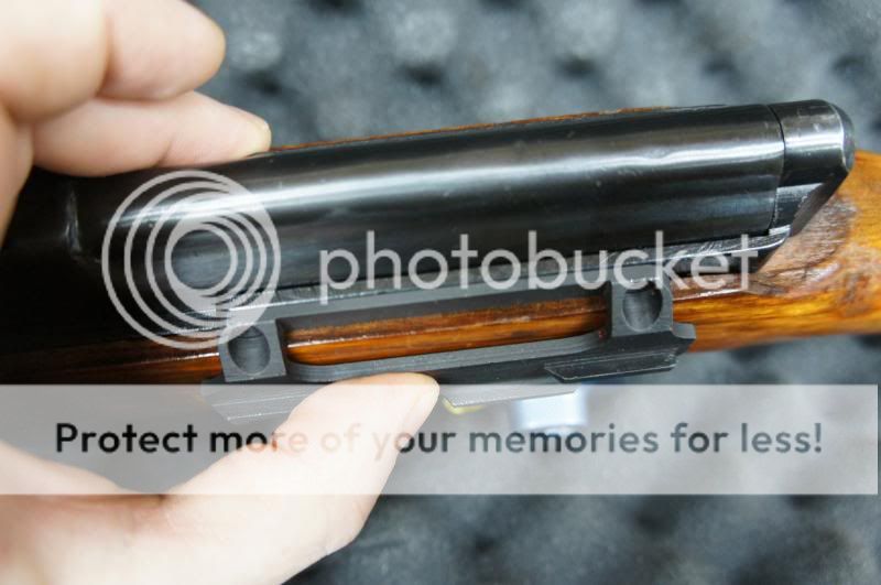

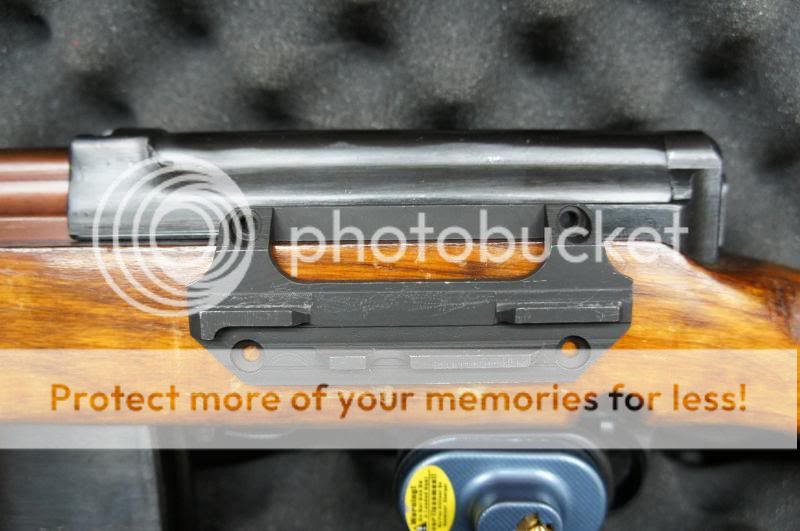

Molot rail...
What it would look like with the Posp and a slip on butt pad (bad shoulder)
There are 3 options I have at my disposal.
1. The Molot rail comes with rivets. Rivets are tricky to seat properly. I have the tools, but I'm not crazy about rivets.
2. I can tack weld the rail to the receiver. and re-blue the welded area.
3. Drill, tap , use machine screws and Loctite. This worked well on my CZ858.
