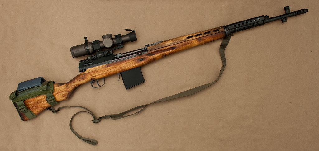

A while back I mounted a home-made picatinny rail to the top of my receiver cover. The joint between the cover and the rail is great, the one between the cover and the receiver slots not so much. I knew it was loose, but I figured that for a red dot sight within 100m it would be good enough.
It wasn't. Not even close.
Looking around I saw some elegant options for mounting a scope, but a quick check of my wallet told me they weren't on the horizon yet.
So I took a look at the interface between the cover and the receiver to see if it could be tightened up. As before I was reluctant to do anything that would irreversibly change the metalwork (although not as much as before).
What I ended up doing (similar to the magazine feed lips) is to attach blobs of solder to the receiver cover in 3 locations on each side, and then file them down so that they just filled up the clearance between the cover and the receiver.
The sketch is misleading, as the actual remaining thickness of the lead is very small (maybe 0.010") or less.
The finished object looks like this:
I left the recently-acquired scope attached for the photo, mostly because there's no reason to take it off.
The best close-up I was able to get through improvised lensing is:
Now the cover is a snug sliding fit on the receiver, and there is no detectable free play between the two (which probably limits it to <0.002" as I could likely detect that).
Once the mother-in-law arrives for the holidays I'll head out to the range to try it out. I am hopeful.
Also, I like the way it looks, boogery fuel tank sealant and all.
The consistent pattern of horizontal lines works well with the shaping of the receiver.
Not as cool as the OEM mount, but cheaper, and it gives me more flexibility about what optics I want to mount.
Also, note the single wrap of electrical tape that stopped the magazine from wobbling side-to-side.
