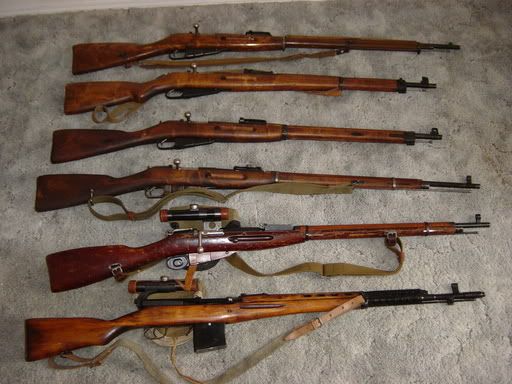

I am pretty sure it is a repro, although the person that sold it to me swears that it is not. It is a lot of fun nonetheless. The PU sniper in this photo is authentic, and a sweet shooter in any case.
