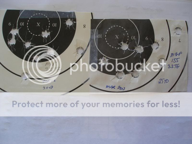

Here are two groups shot from my M&P. The left one is 20 yards, shot 2 handed. The right one is 25 yards, rested.
The load is 3.3g TiteGroup under a 155g SWC. This is the best load in this pistol, and also in my SIG and Glock.

.40 M&Ps generally shoot well. Most 9mm M&Ps shoot OK, but a significant percentage have accuracy issues.
