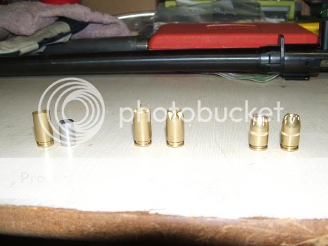

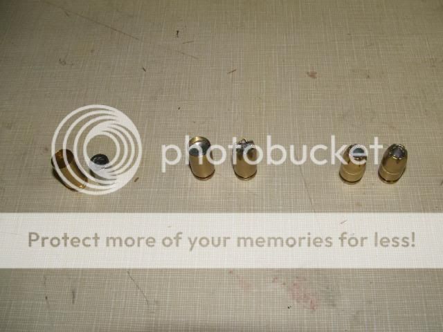

I just got my new notching die from BT_Sniper. Works super! It's a universal die and can be used on 9mm up to .45 cal!!
Here's a few pics.
This pic shows the two parts of the bullet: The .40 cal case and the cast core(175 grs) The middle pic shows the core seated and the case notched with the new die. The right pic shows the bullet formed and cannelured. You will notice the two different size notches. That's done with die adjustment. I prefer the longer notches, myself. The bullet goes 245 grs. Should go real good ahead of 20 grs of 2400 in my 8 3/8" M-29!
