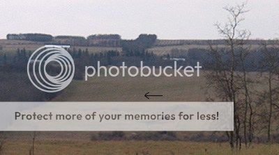

The small white dot on the other side of the valley is what a 18" x 24" target looks like with the naked eye, when seen from 1 mile. It's just to the left of the trees in the middle of the pic. Just above the small rig you see in the clearing

Am I blind? I need a big red arrow pointing at it.
