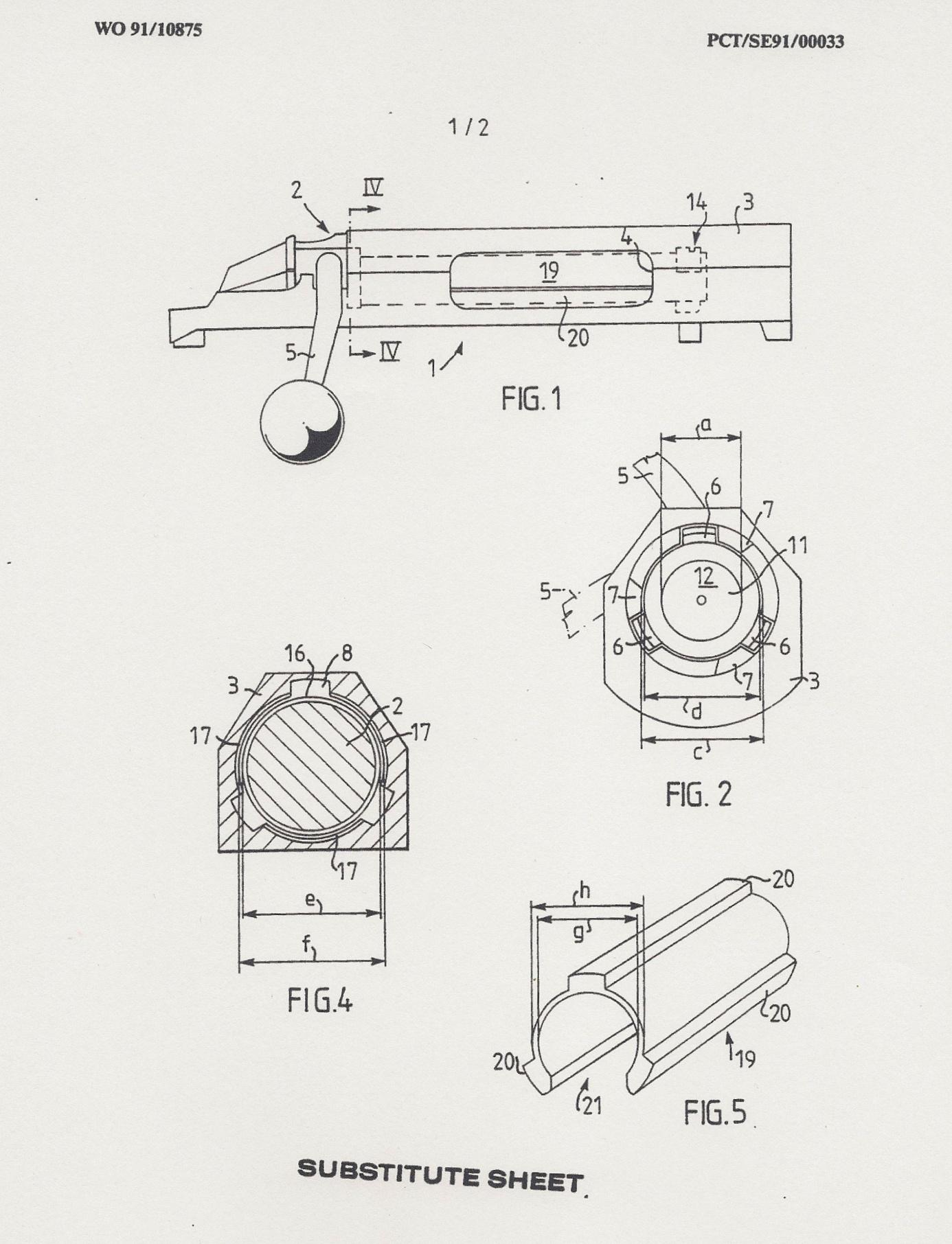

Anyone know anything about this firearm? Was selected as the Swedish sniper wpn system.... but after the financial packages were reviewed, the Accuracy International submission was defaulted to...I am specifically interested in the action and bolt design..thnx
Lano. 3 Lug bolt with dual recoil lug receiver.
https://www.forgottenweapons.com/sniper-rifles/swedish-lano/

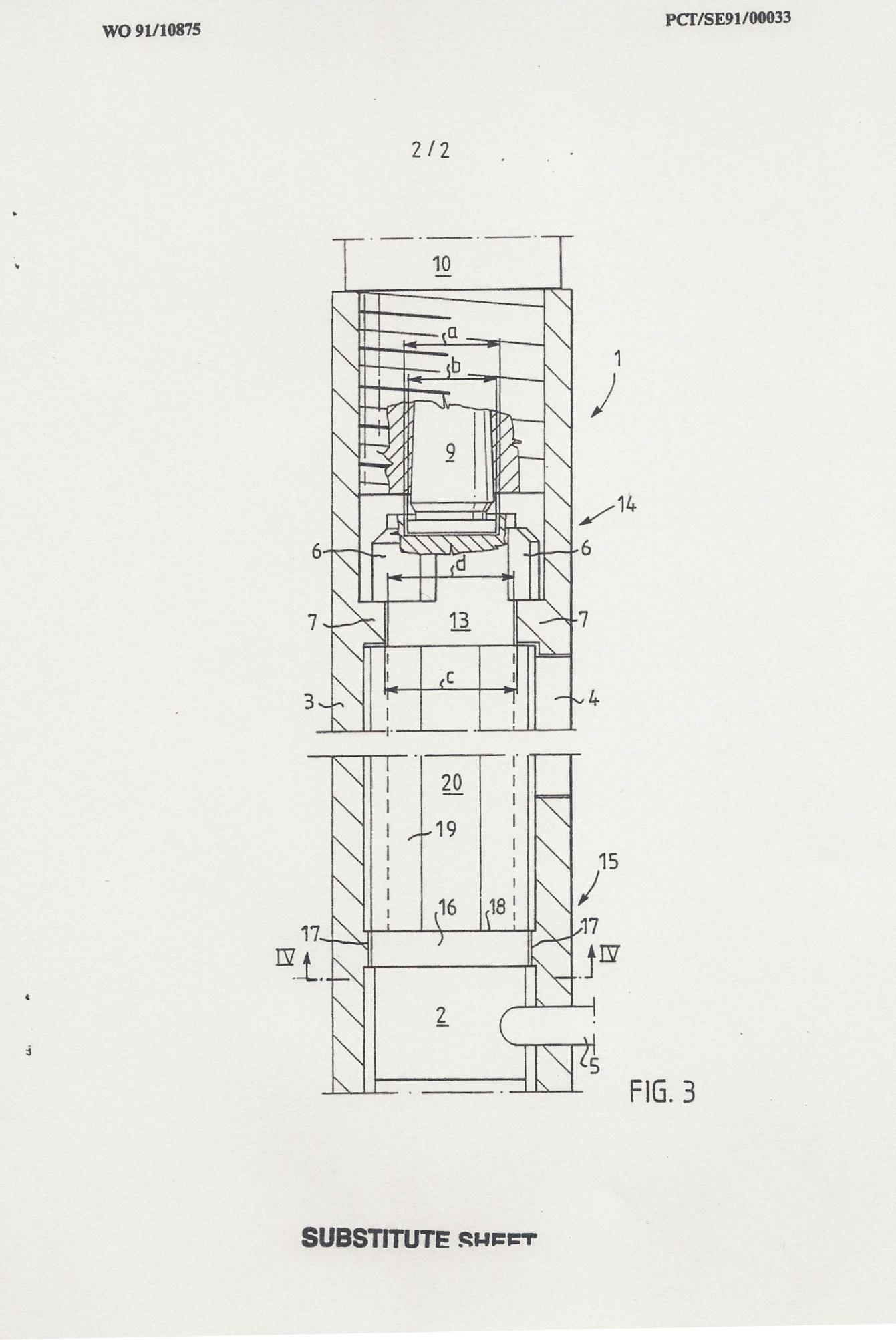

Thanks...looks like a TRG... they make some claim about centering the bolt etc perpendicular to bore... I was curious if they used Palmisano's plastic collar like Tikka did for a while. Although the drawing shows that the locking lugs seem to provide little clearance laterally to the bolt
