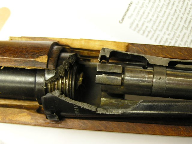

Good Day,
The Swedish iron ore and its steel production is recognized as metallurgically excellent and has been in use for well of 150 yrs. Everything has a failure point and context in this instance is critical. I personally inspected the Swedish rifle I've pictured and know why it failed- wrong powder! The individual packed the case with what turned out to be something similar to black powder. Under a similar circumstance (through ignorance or disregard), any rifle can and will be pushed beyond its limits. With proper caution (powder/bullet weight), the Swedish Mauser can handle a 30-06 without issue.
Following WW2, Carl Gustaf Fabrikwerke produced an "Employee's Rifle" for its workers and for commercial consumption in both 6.5x66 and 30-06. Its unlikely that such a manufacture would have produced the Trapper Lyx or Trofe rifle series in large quantities* if there was concern that rifle could not handle the pressure gradient produced by a 30-06 (within normal limits). Again, as long as excessive loads are not used, the Swedish 94 action should be fine.
