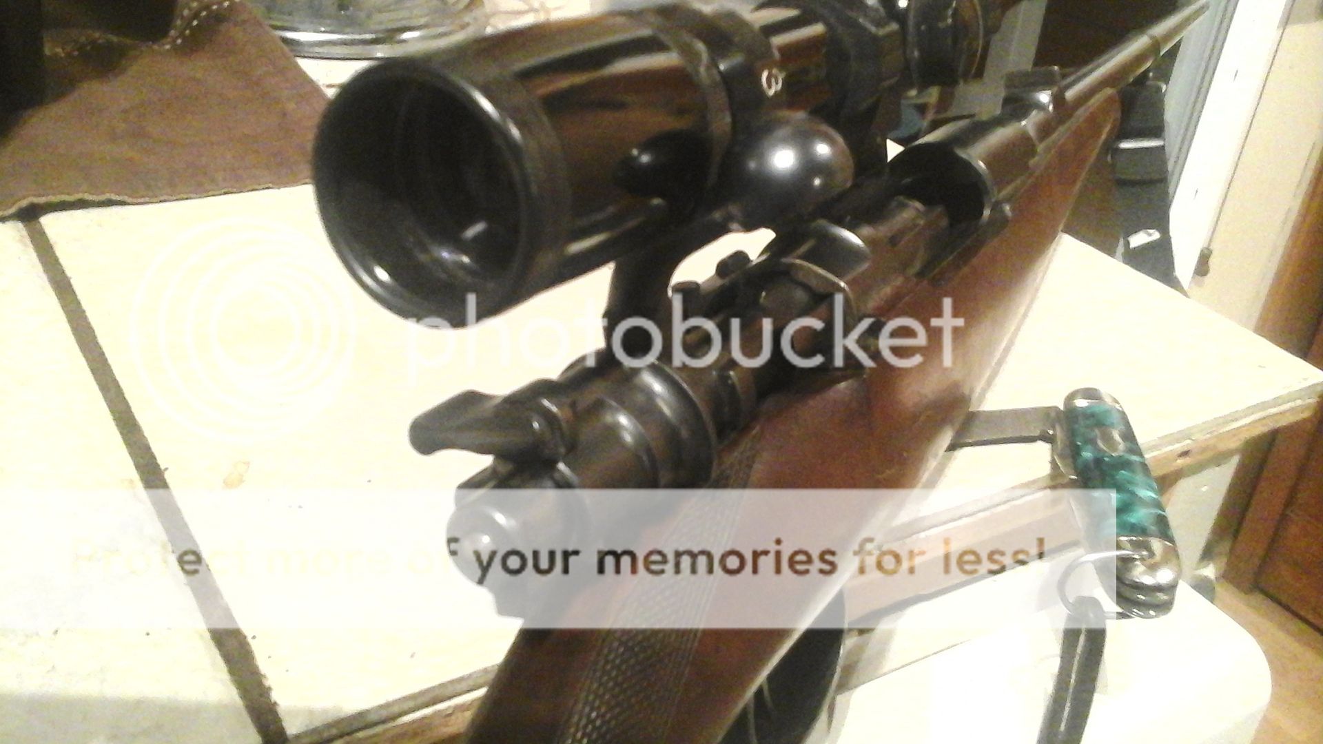

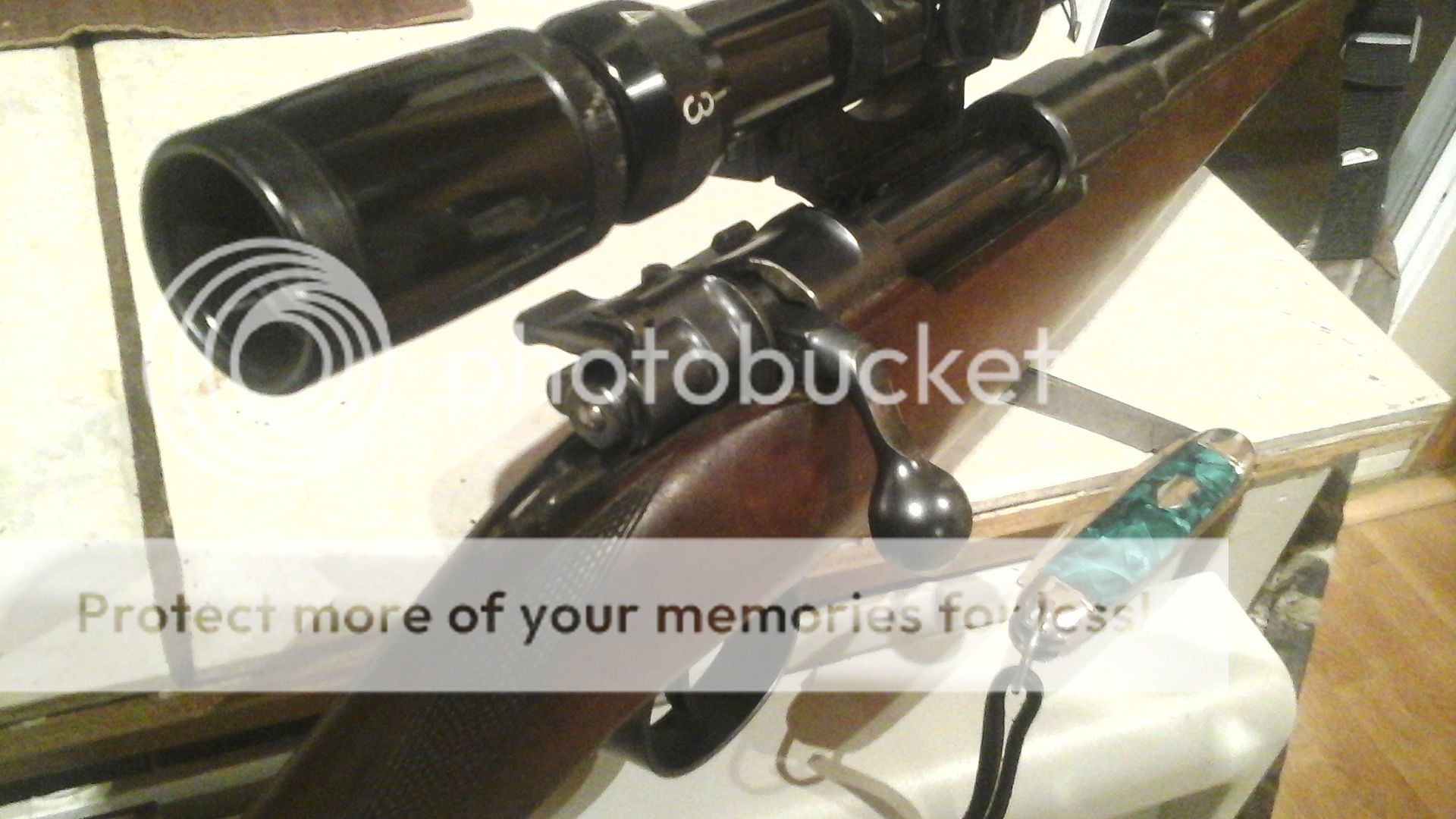

Whoa! Tell me about this Mauser SSR!! Sounds interesting. BTW, mine is sporterized, but not the bolt.
Well you turn a thumb screw, flip a switch and slide the telescope off rearward. I've a scrubbed K98 with one that I installed myself.
Looks like this
