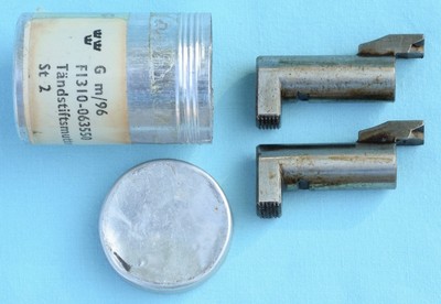

The safety issue I described above is common and fixed by removing material from the cocking piece nose. I've never come across one where the safety was impossible to engage, a few where the safety needed thinning to engage but not like you are describing.

Something I see from your picture is that the front of the cocking piece on that one is full profile all the way to the threads. On mine both the original and the replacement are milled away to almost the ramped section or the beginning of the incline. Maybe I could just cut another slot on the top of the cocking piece to engage the safety?

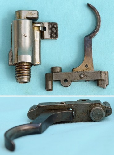

Trade-ex lists, or at least used to list, NOS strikers like shown in Post #9. The lip on the striker engages on the sear, not on the "trigger". If bubba has been at it, you might want to confirm the sear is original height and depth, as per pictures in Post #6. When properly installed and fitted, operating the thumb safety lever on the shroud should pull back the cocked striker visibly - .030" to .050" - it is supposed to pull the striker completely off the sear. Operating the trigger / sear mechanism with the safety engaged (or with the bolt removed) should always bring the sear back up to proper height - else something in the stock cavity is interfering with the rocking motion of the sear. When you release the safety, it should set the striker lip back onto the sear.
Yes the new sear I got from Trade-ex is taller than the one I took off. I have the replacement trigger and sear in place and they function as you say. Was it common for people to basically shorten firing pin travel in this way? I guess that the cocking piece I got from trade-ex was already modified? I hope to order a low swing safety eventually to use with optics. Maybe primer strike would be ok with the shorter travel of the firing pin. Have you seen this before? Thanks, and I'll see if Trade-ex has alternative cocking pieces.
