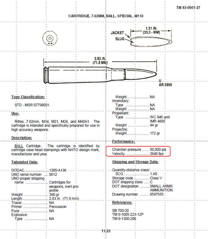

Actually they were designed and sight calibrated for 7.62mm Nato (a lower pressure load at 50,000 psi.). They were for use with service ammo supplied to all shooters on the line so no one had an advantage with ammo. My Swedish 7.62x51mm CG-63E is chambered and setup for that round. I shot 1000 yard Service Rifle matches with government/military supplied 7.62x51mm nato military ammo over open sights, this rifle was designed for that type of shooting, not using commercial .308 or hand loaded ammo.

7-62-cartridge-specs-jpg.15970

Thankyou for that informative post, I wasn't sure what the deal was with the 63E but that cleared it up.
