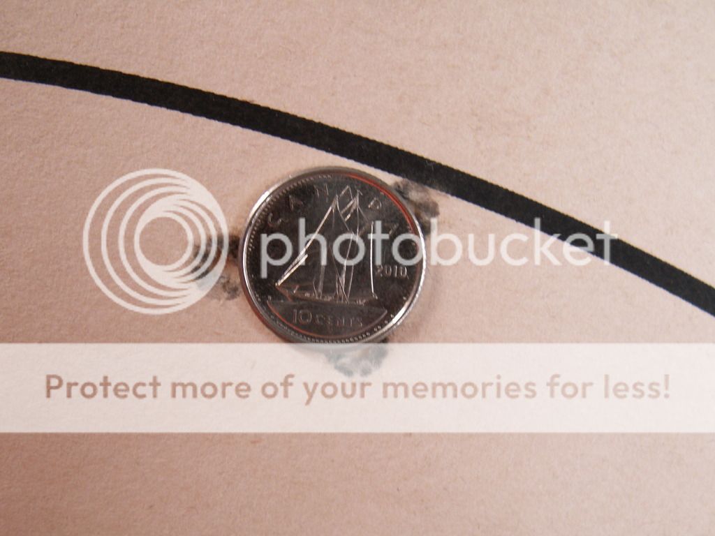

This is a four round group at 100 yards, typical of a good FSR rifle and developed handload. When developing loads, I shoot four round groups, and I "called" this group before I shot it. SMELLIE was watching through the spotting scope when I fired this one.
[I
MG]http://i581.photobucket.com/albums/ss251/wayne-max/rifle%20forum%20photos/20120625_6.jpg[/IMG]
