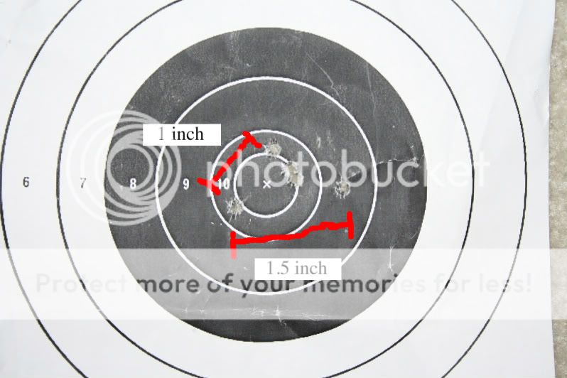

Perhaps you're not the greatest shot...or something.
This was shot at 100 yards with my Black Special with the bipod, and rear end supported only by my shoulder, with American Eagle 55gr FMJ (basic stuff).
The OP had 10-shot groups, not 5 -
I think 10 shots are more indicative of actual "real life" accuracy which might explain why there are somewhat larger than the 5-shot groups shown above.
Could be wrong, but I have noticed that my 3-shot groups are always tighter than 5-shot, & my 5-shot groups are always tighter than 10 shot.
My rifle and I shoot similar to Styraks results, 1.25" to 1.5 " at 100m and 2" to 2.5" at 200m (the good 5 shot groups). Mine likes AE and White Box 55gr.
When I go for 10 round groups they open up, that's normal and depends alot on the shooter being able to hold the same position after the mag change.
Its also getting a bit old with people comparing everything to a benchrest rifle and trying to use it as such. These types of rifles were never meant for that and if it shot 2" @100m that's all it needs to do for you to hit your target out to 400m from a field position, which is what it was made for.
Way too much emphasis these days on "my black rifle needs to shoot sub moa" and not enough on developing rifleman skills, I see this at the range all the time. You can't carry the bench with you to the field, use it to sight in your rifle and then hit the dirt and at the very least practice your prone position and get good at it. Good marksmanship is what scores hits not the rifle.
Most of my 5 round groups look like that too... hell, I've shot 200 yard 5 shot groups that are smaller than that (1.2" with my hand loads)... but I find taking it to a 10 shot group adds about 40-50% to the group size of a 5 shot group.
