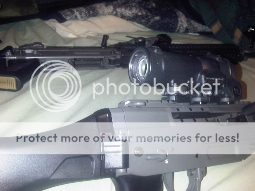

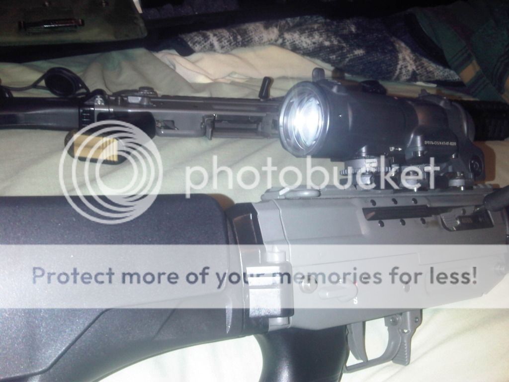

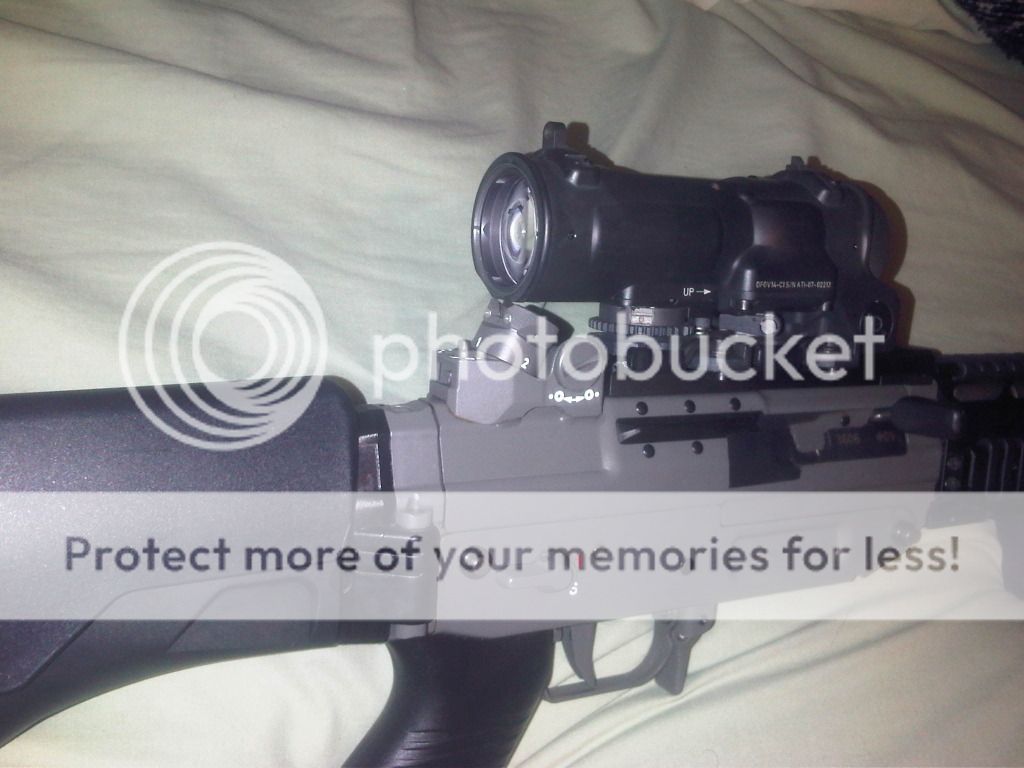

I have a Flatop CQB and a fullsize Swiss with the diopters and I've tried my SpectreDR on both of them. For the fullsize, with the irons, a cheek rest really does help. I didn't notice any problems on the CQB, but I also slapped an H-1 on it the following week. Gimme a bit and I'll get pics of both of them with the SpectreDR mounted.
Excuse the s**tty cellphone pics.
You'll definately want the riser for the irons model, but it could go either way for the flattop model.

Surefire
I have never seen an upper hand guard like that before? Where did you gt it? Do they make it for Standard and CQB length models? Any other details would be great.
thanks
That is a surefire light fore end. Very rare from what I have seen as they don't make it anymore for either size
