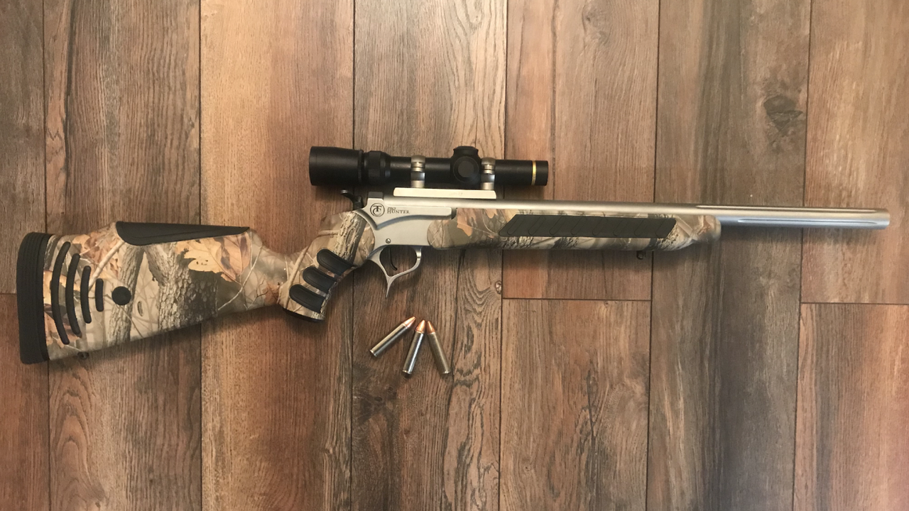

I have one in 460s&w. Its very nice to carry as its so short! I prefer it over my 45-70. I havnt shot anything with it yet, but think it would make a sweet srand gun for WT :)
Very nice! How long have you had it / where did you get it? Am in process of sourcing one now...
I have had it for 3 or 4 years. I wanted one bad as I also have a S&W revolver in 460. I ended up finding components- frame, barrel and stock’s separately and putting it together. Not a huge fan of the camo stock, but it was all I could find at the time. Stock and frame I found on the EE here and the barrel I got from a fellow that deals with barrels... His company is called NINE35.
