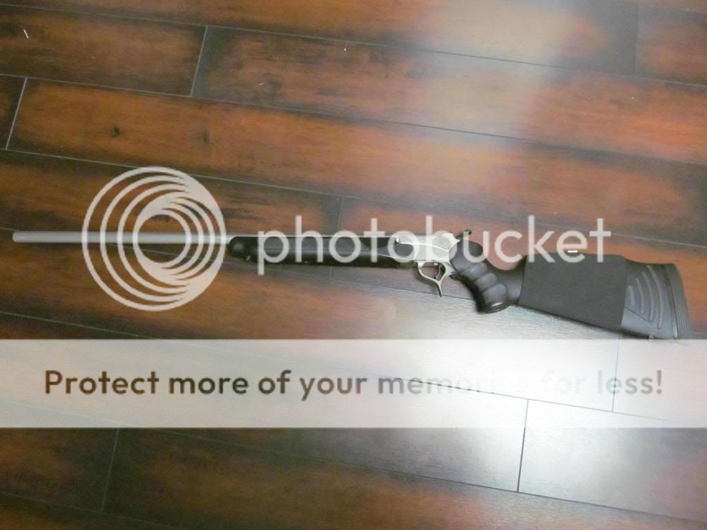

I've been putting together a T/C Pro Hunter in 8X63 Swede. The barrel started off as a boring 30/06 so it got boxed up and shipped to Ron Smith. He worked his magic, and before I knew it Ron had it punched out to 8mm(.323") and rechambered to the not so boring 8X63 Swede. I plan to shoot 200gr. bullets that should have plenty of thump for most any NA game. Here's a couple pictures of it.
Hope to get it out this weekend and see how it shoots.
I'm guessing there are not to many pro hunters chambered for this cartridge:cool:.

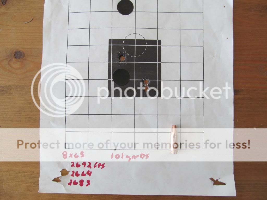

Just an update. Had the T/C swede out this weekend. Quite happy with the first few groups. I put a leupold VXII 3-9X50 scope, Mike bellem up grades,over sized hinge pin and spring kit. That took the wobble out of the barrel.
The load was rather tame.Factory brass and primers (1941) 200gr. Nosler accubond 55.5grs IMR4350 @ about 2670fps. Found one of the bullets in the snow,it's on the target.
I'll do more testing to find the sweet load.
I had some hot 180gr. loads @ 3010fps, I backed them off to 2875fps.

I have done more testing and have settled on the old silver 196gr. Norma dual cores. running at 2860fps. 3 shot groups are a 1" or less on my better days.
The 175gr. Sierra pro hunters are just as accurate running 2940fps. Sorry no loads for Barnes.
