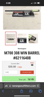

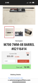

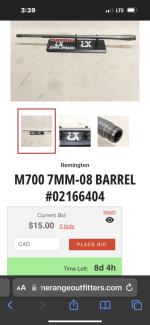

Thank you for that. Better to look for a 700 barreled action.
