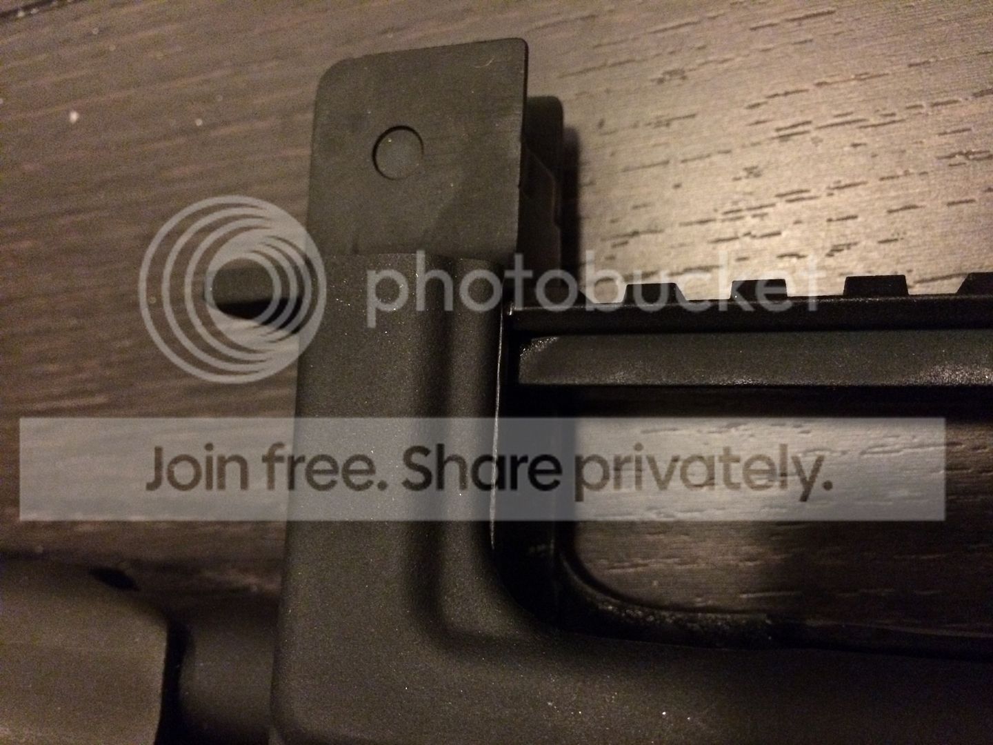

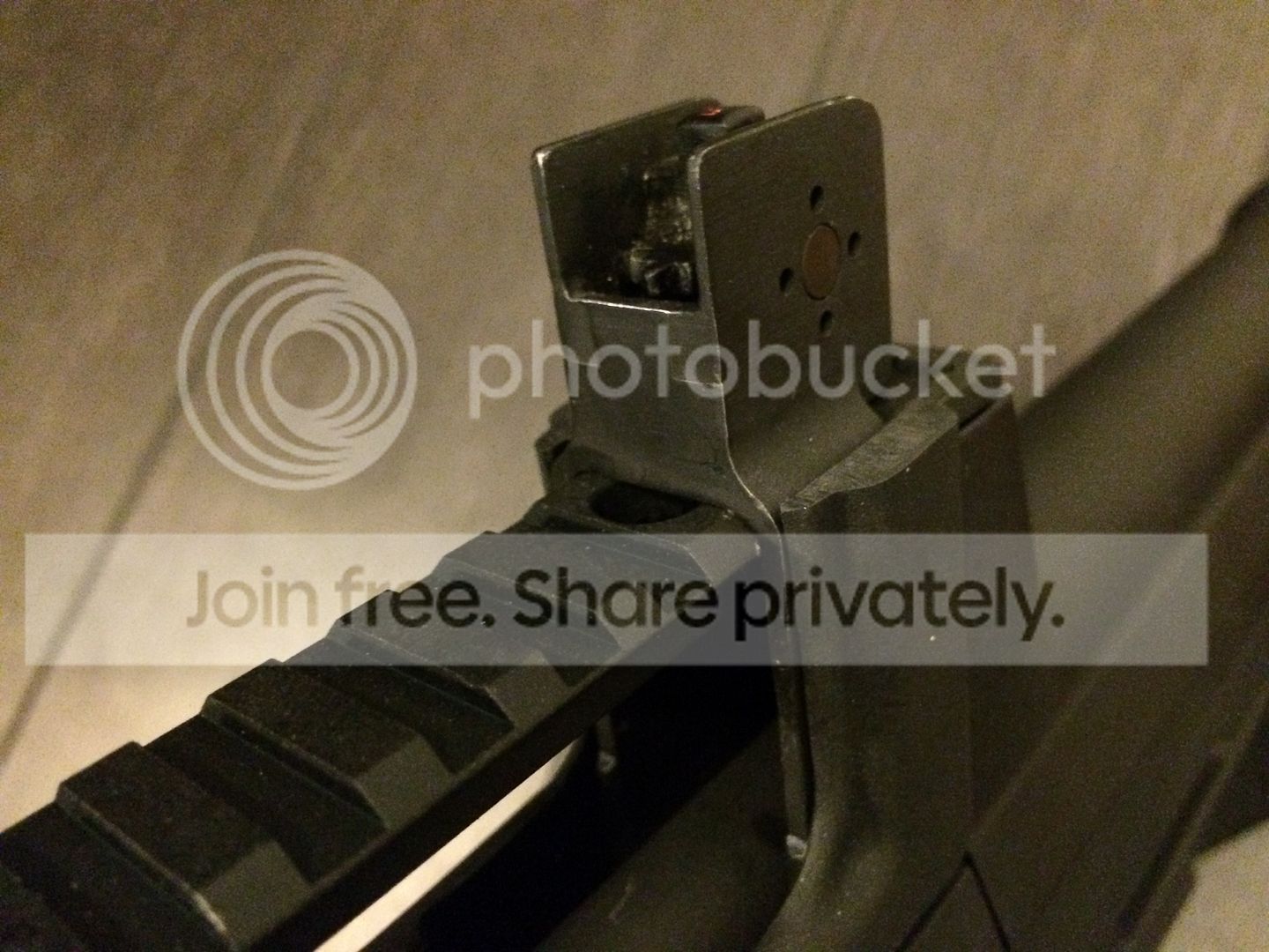

1.), cut down the front section of the rear sight post, touch it up with paint/finish of your choice. You also need to cut down the plastic carry handle. How-ever far you want this to be cut is up to you, I chose to stop at this point.
Front of carry handle:

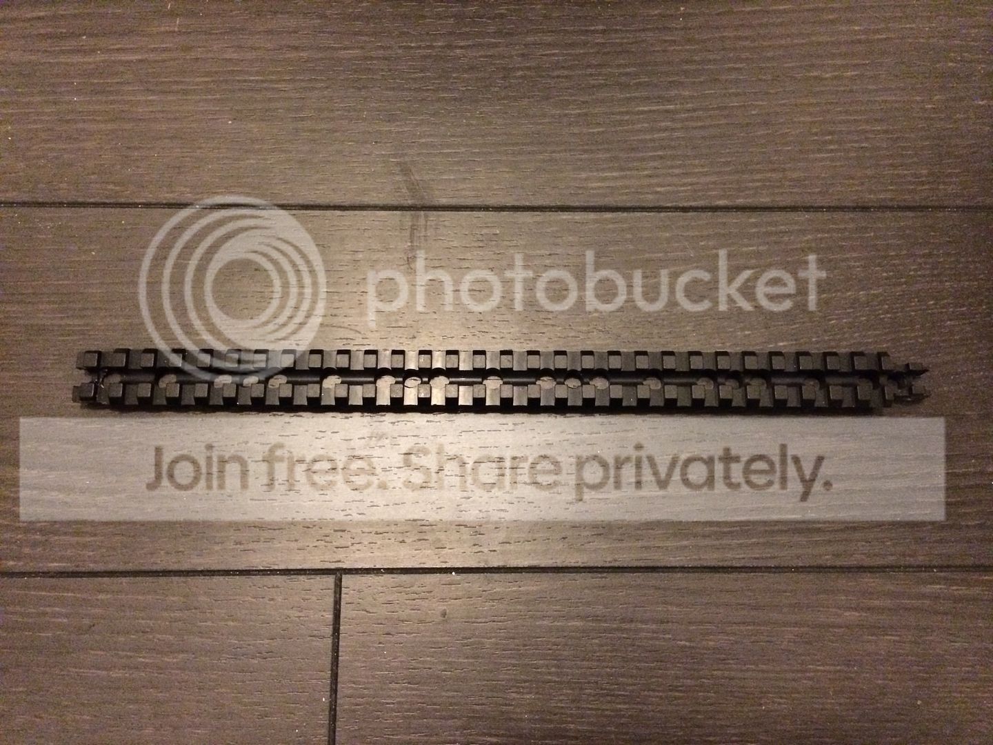

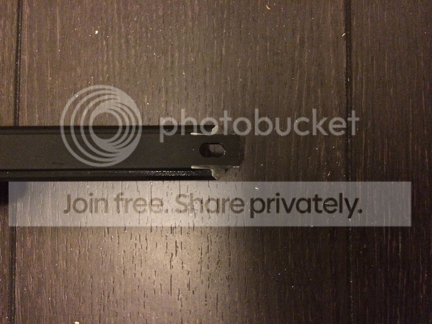

2.), source a rail that is at least 12" long. I had an AI AX Chassis rail that I didn't need anymore, so I used it as the first prototype. While it seemed to work quite well, it had some considerable flex in it if you really press down on it, since it has a centre ridge and many holes.

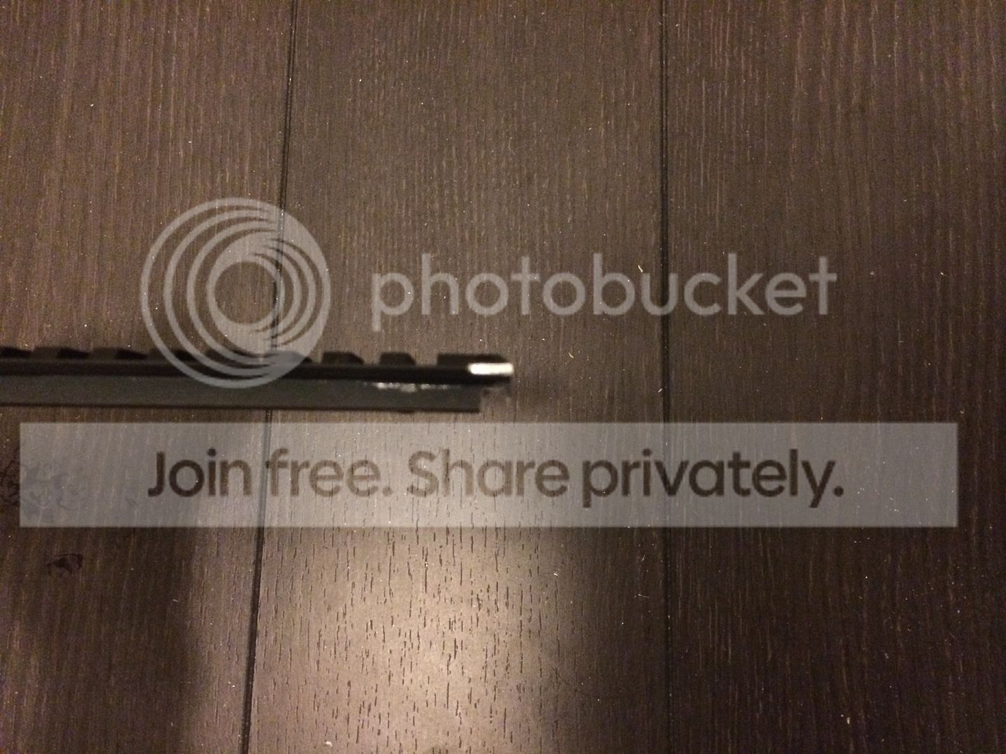

Later, I sourced another rail which did not have any holes, or ridges, and did the following mods to it. (Nevermind the front and rear holes, they came that way.)

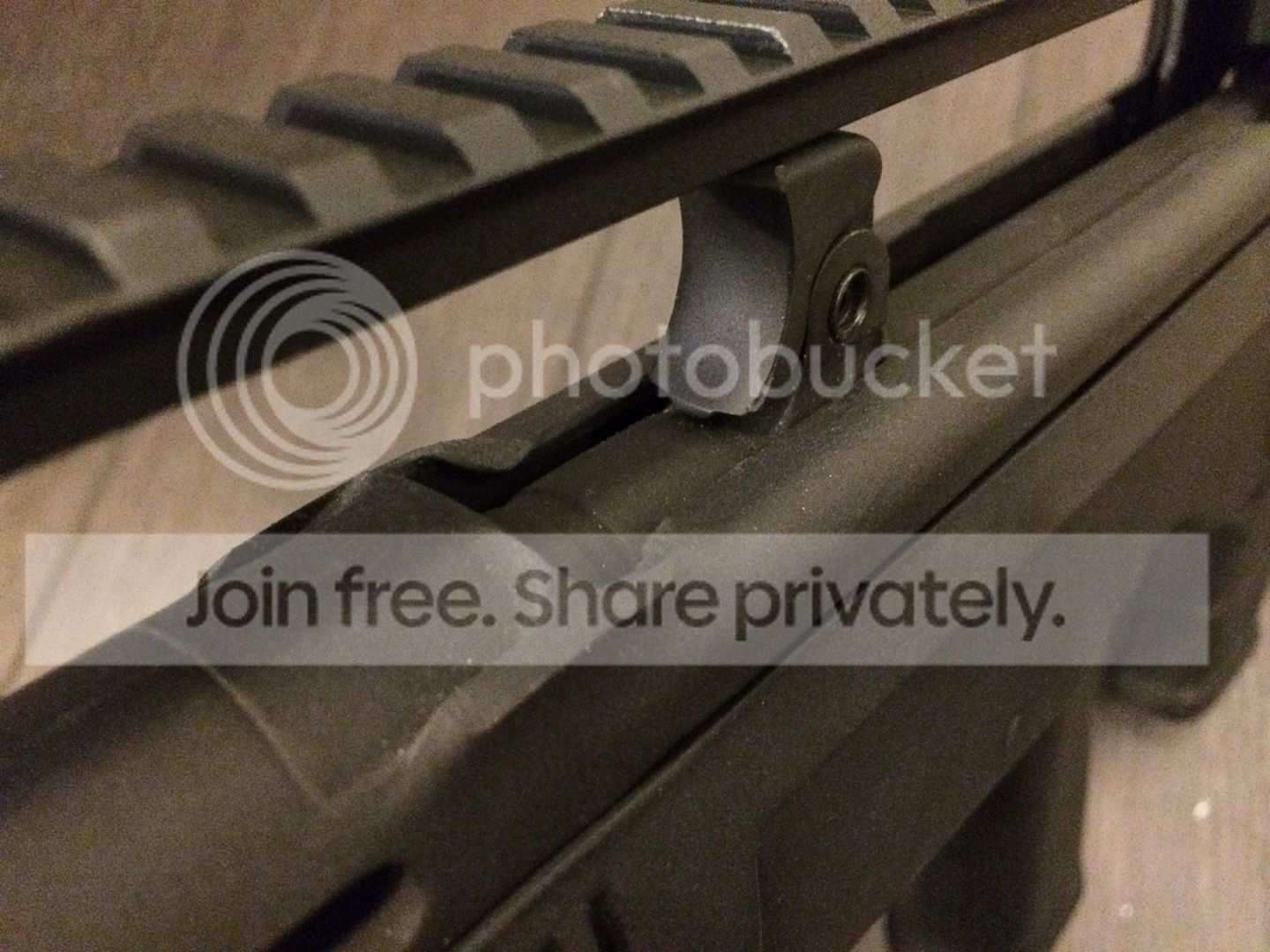

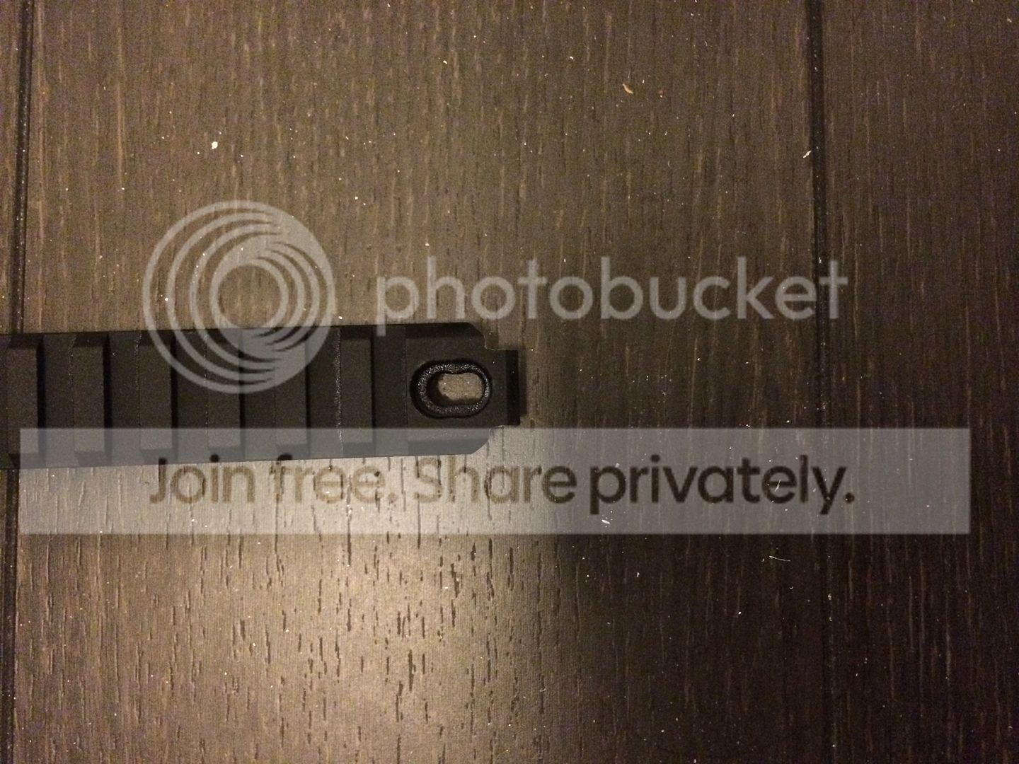

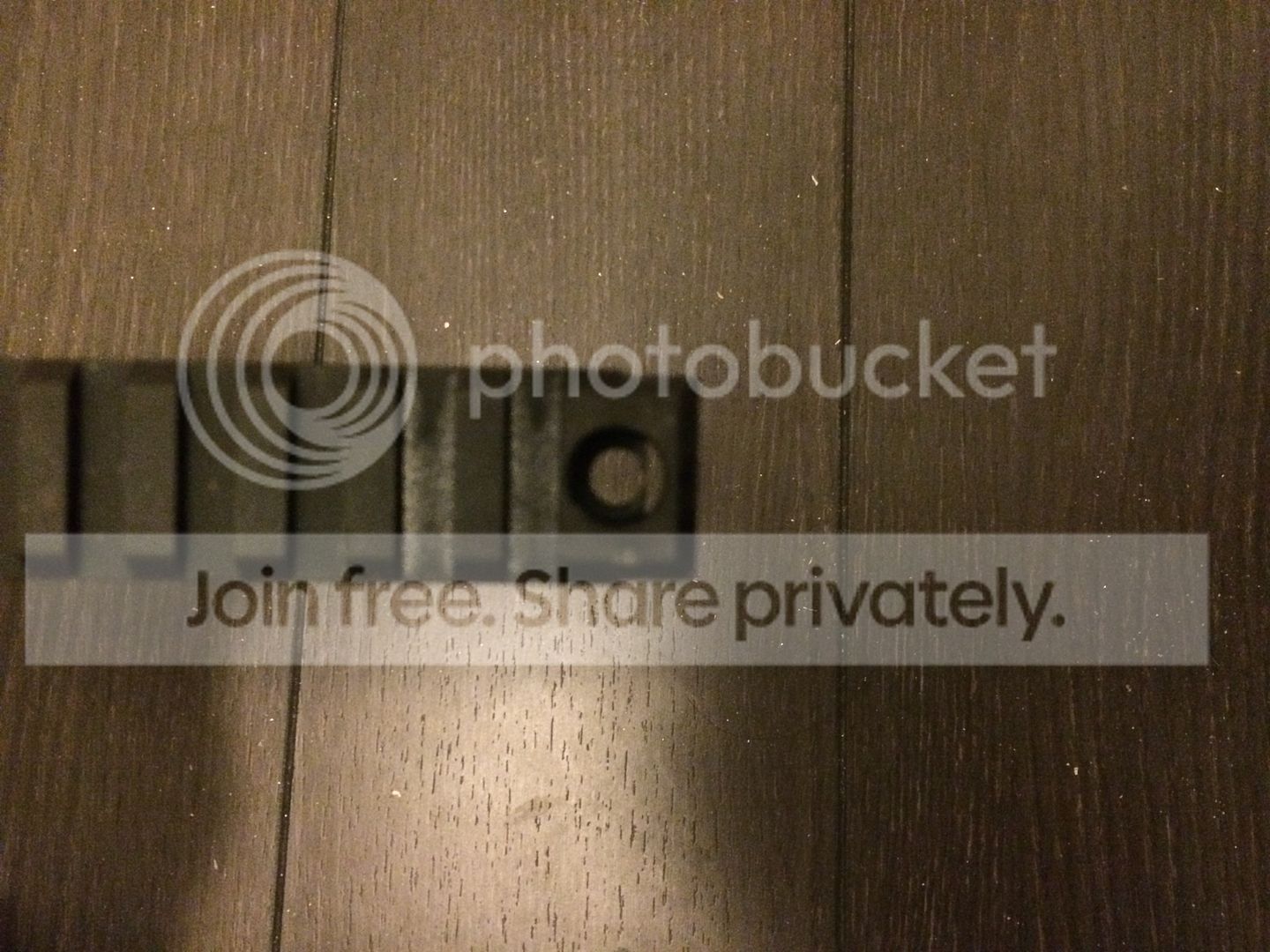

Front:
That slot is a milled to be 5/32" diameter. However deep depends on the location of the holes drilled on your front sight post.
Top
Bottom

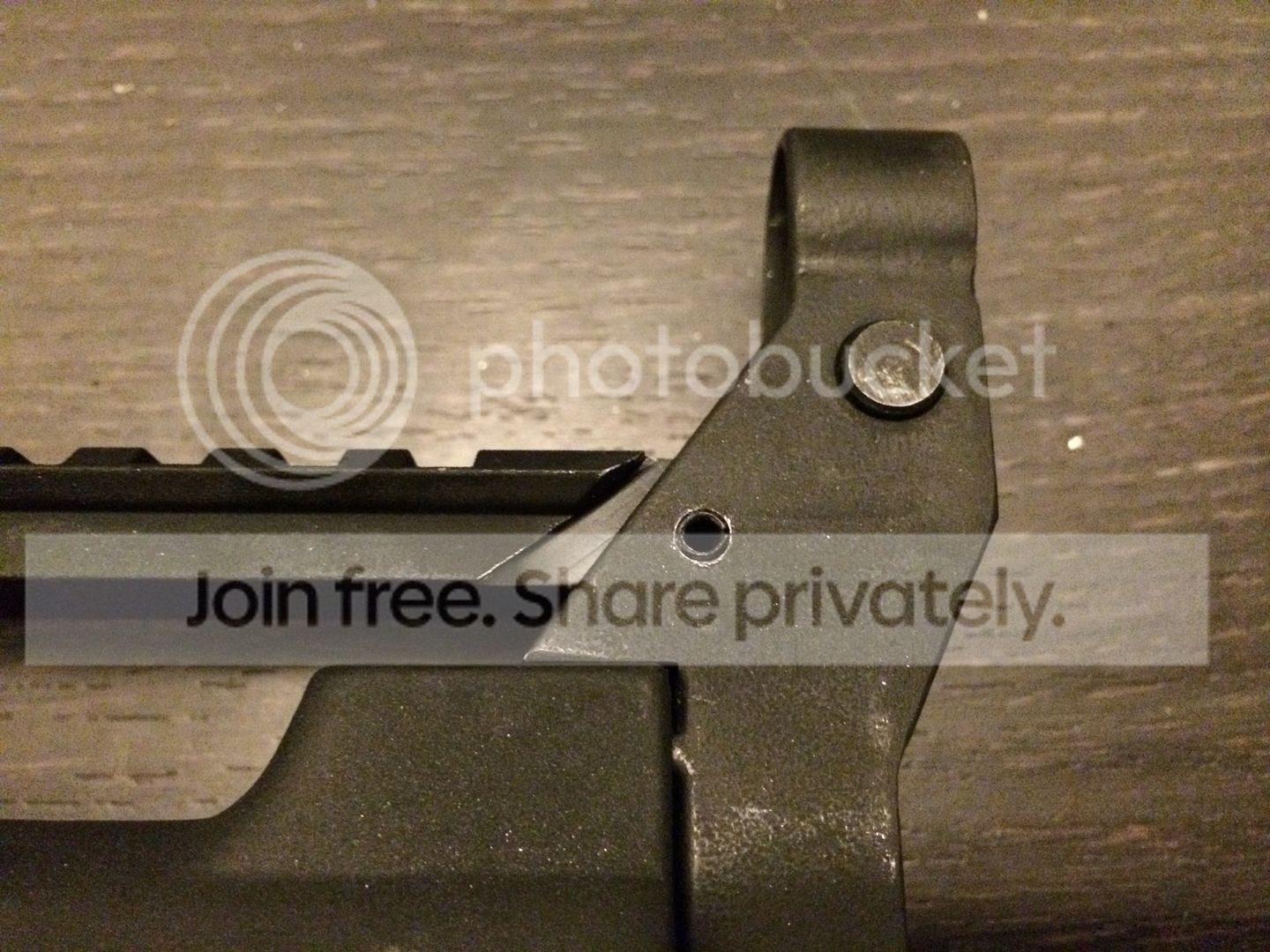

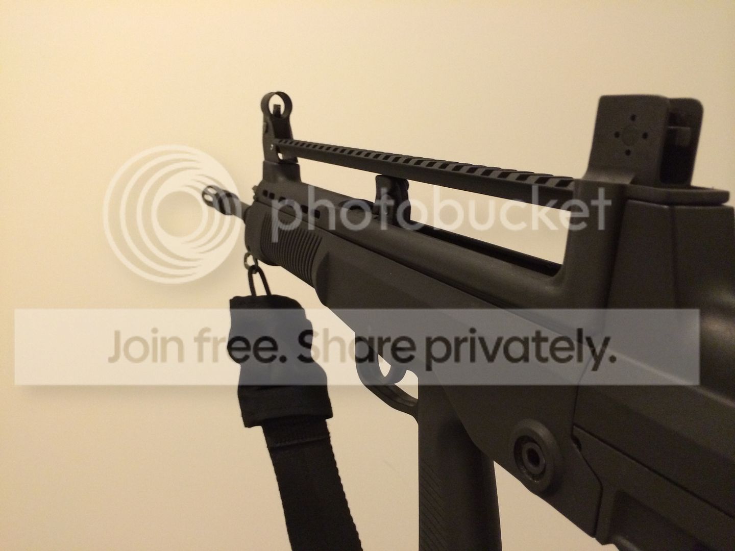

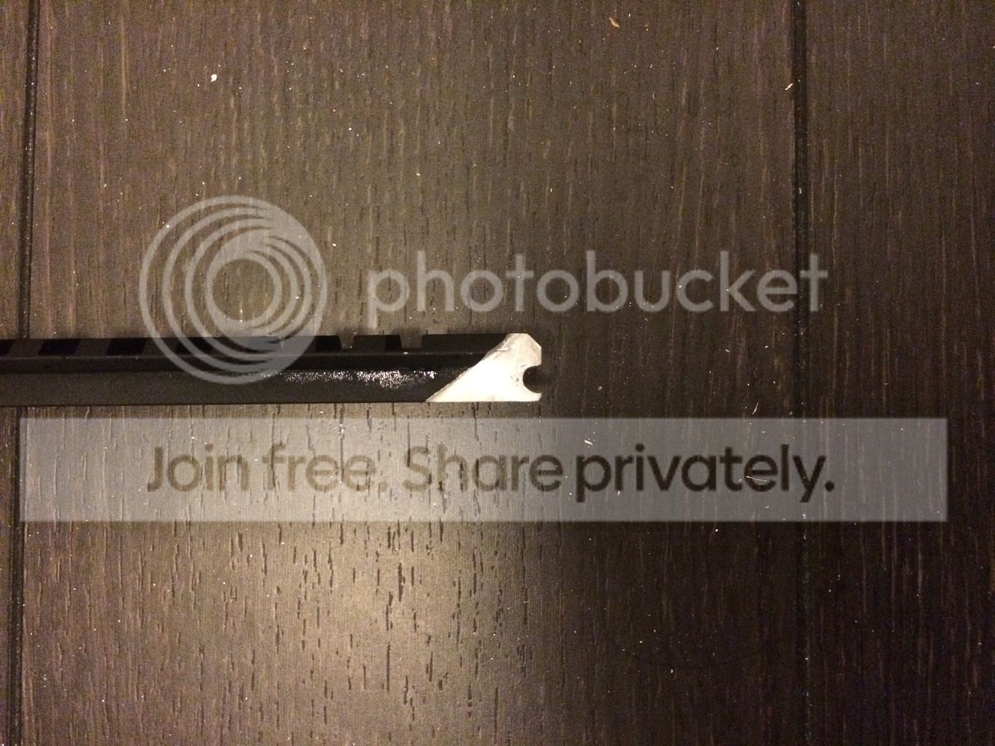

Rear:
Note the bottom of the rear-most part is removed. However, do not remove too much material, as it will affect how well it locks up with the rear post.

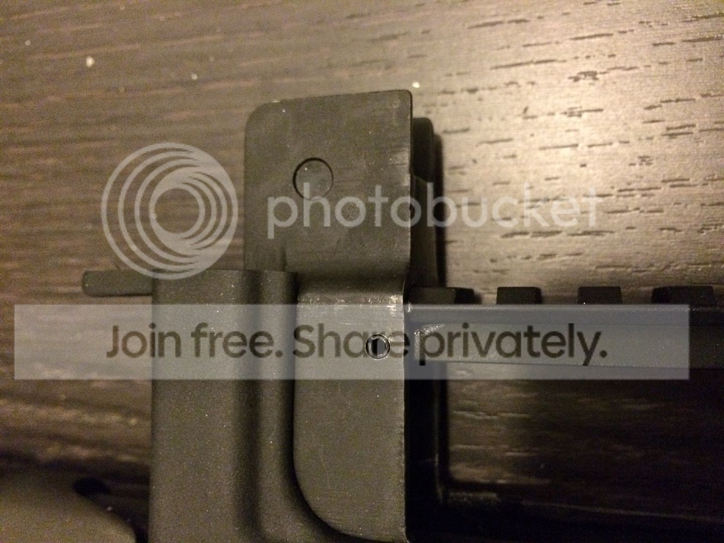

3.), drill your front sight post and pin the front of rail to it. I used 5/32" drill bit:
4.), drill the rear post and pin the rear of rail to it, I used 1/8" drill bit:
Make sure your roll pin doesn't protrude. Close up the plastic piece!

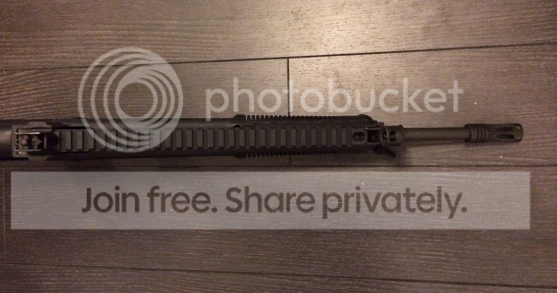

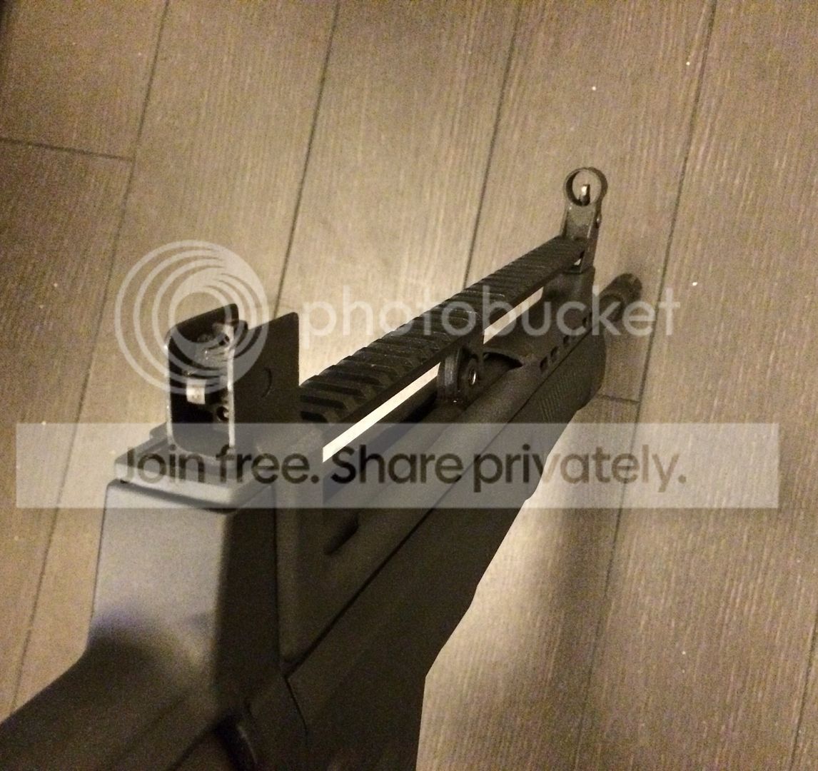

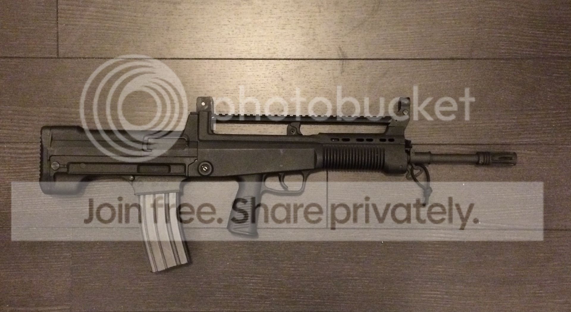

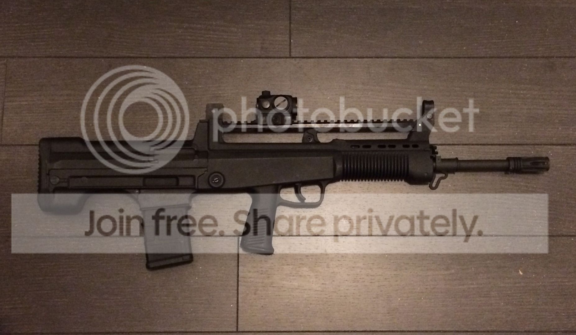

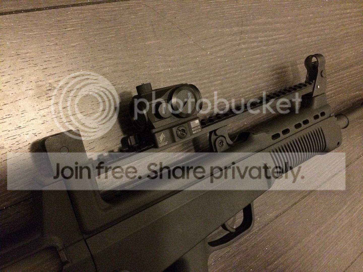

Finished! :cool: (Obviously there's many more steps in between involving careful planning, measuring and executing. However, every gun from norinco is probably different, therefore I purposely omitted dimensions.)
The result:

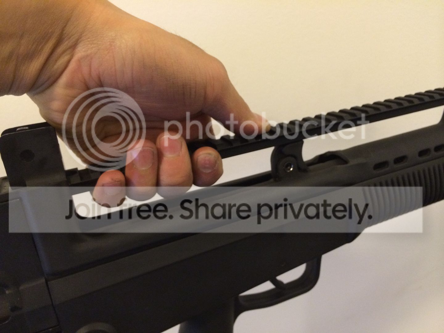

Yes it is still a carry handle:

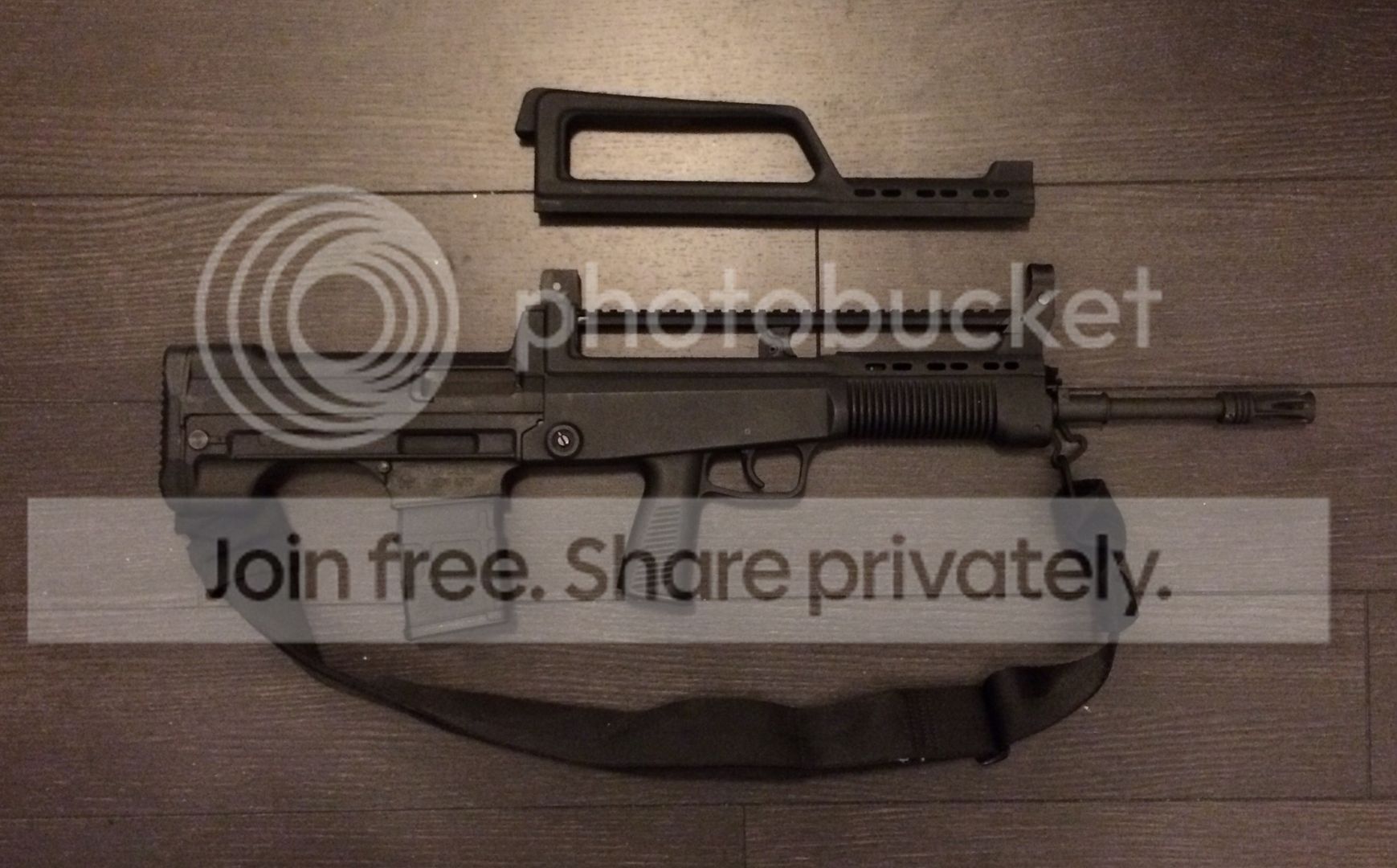

Best part is, if you can source an extra carry handle, you can reverse it:
