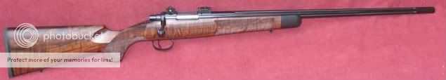

The 20 VT is one of our top sellers. A lot of performance from that 'little' case and the sweet little M38 action.

We've got this 20 VT built and it will be on the next shipment late this month. thought it might be nice to see:
