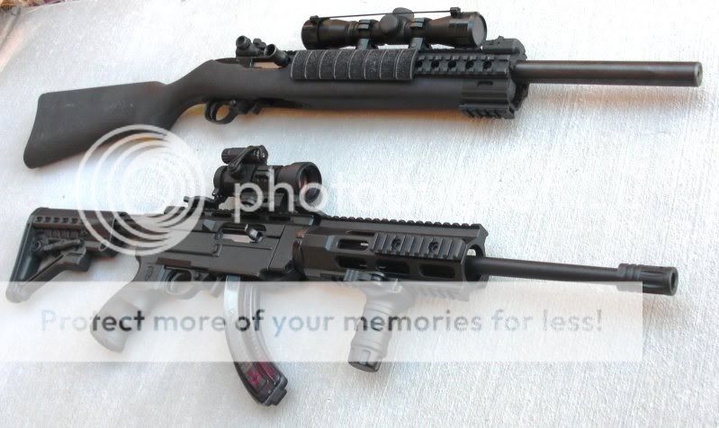

That's why I said "kind of" the look I'm going for. Wood plus cheap rail system looks all wrong, I agree. My 'motivation' for this project comes from seeing this picture, and the rifle on top:
It's a 10/22 with some mods to the action, stock painted black with the Leapers/UTG rail system installed. It's simple and understated and pretty much exactly what I'm trying to do (plus adding a bipod), albeit with a Cooey or Savage 64. For the price of one 10/22, I can buy 2 64s.

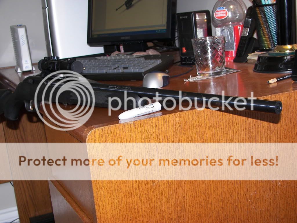

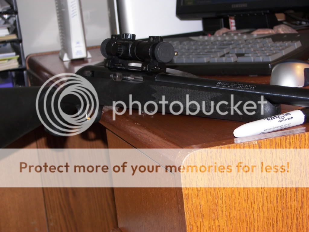

You're absolutely insane and, what's worse, so am I! I just picked up a nice 64b and I'm thinking of making it look like a miniature semi-auto 50 bmg or something like that. (Without any permanent modification to the original stock or the irons.) I'll post pics whenever it's done.
My Savage 64 w bull barrel.
It's got a bit if finger print rust.:(
