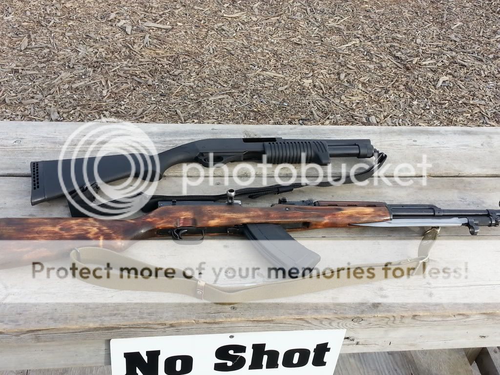

No plastic stocks and crap like that. Just some subtle yet classy tactical enhancements.
I have done up a Tapco back in the day, and regretted it so here is my new project.
Started like this, after refinishing the stock.
Then picked up a Tapco mag at the range today. Yes it is still plastic but I am not spending 100 bucks on the steel ones, and they are far too long and look ridiculous not to mention they make it impossible to shoot off a bench. This one is just right. ;)
And when I got home from the range my brand new steel hand guard was waiting for me so I through that together, and removed the bayonet and cleaning rod to save the weight which does make a difference. Feels much less front heavy now.
Now I am considering chopping off the bayonet and cleaning rod lugs but not sure I want to. Not sure how it will affect resale, and this is a numbers matching unissed SKS so.......
Anyways I think it looks much nicer than all the plastic stock crap. Like I said I have been there and done that and said if I ever got an SKS again I would keep it pretty standard.
Hope you guys like it. ;)

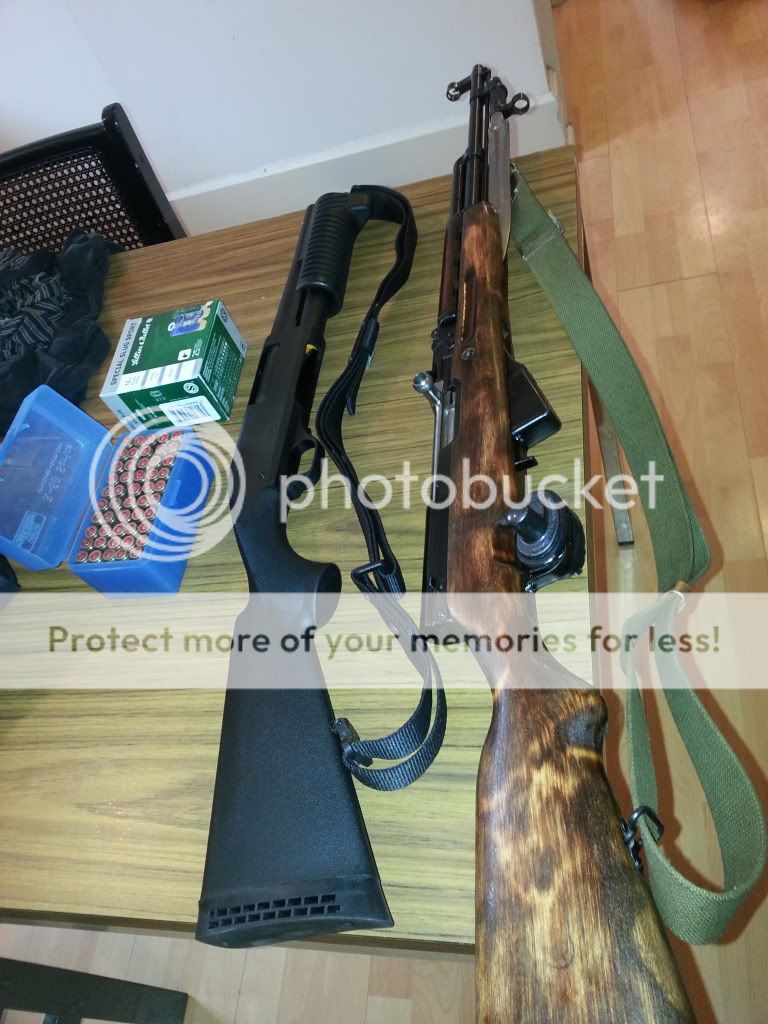

Vented handguard came from Hical.ca.
It uses the original gas tube. The end that locks into the sight/gas block has a pin holding it in place that gets hammered out. The new handguard is fitted(little filing) and then that metal cap is pinned back on.
Really simple mod if you have the tools, namely a vice and the right punch.
The Tapco mag also took some fitting, which basically just involved opening up the magwell slightly for it to fit. Just sanding away some wood is all it took.
Nothing too complicated at all. ;)
