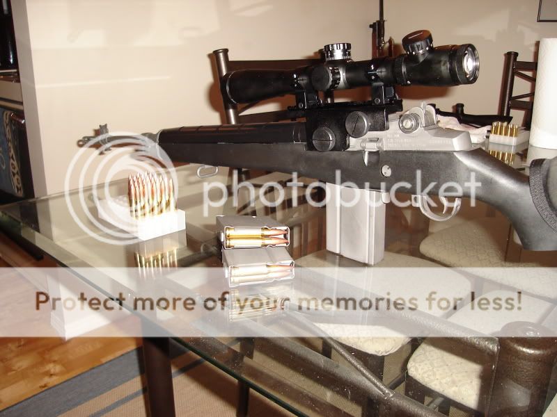

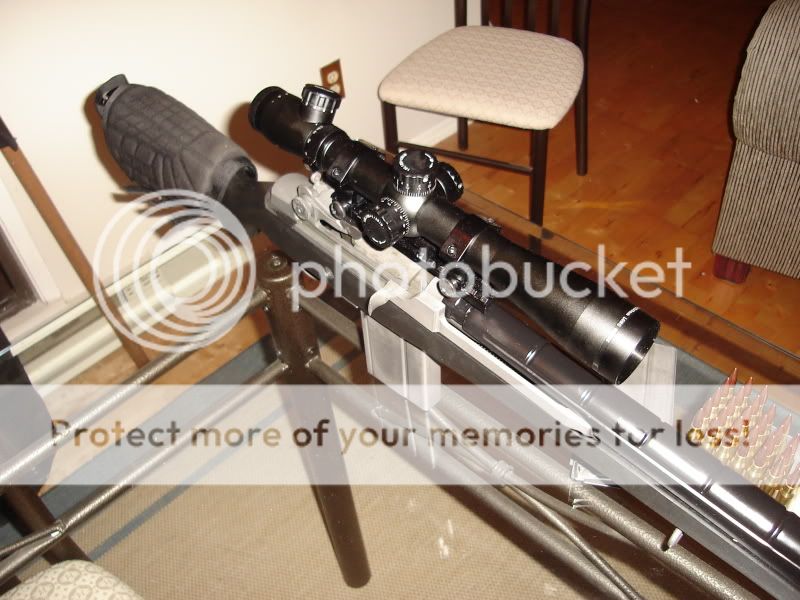

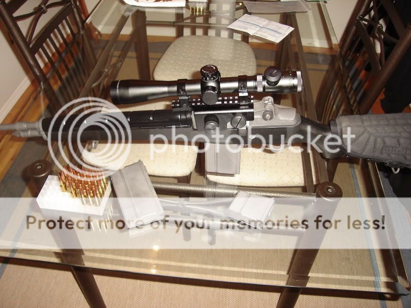

Here are the pics, Tomochan can quote and add text if you like to explain them. Glad to help!!
Many thanks to my new buddy Drewz for helping out re the picture posting. The pics are self-explanatory really - the $25 e-### special mount, knock-off Leupold Mk 4 Tactical which came with free rings. Blackhawk cheekpiece borrowed from my Kimber Tactical. Total cost ( excluding cheekpiece ) well shy of $150. I think if I had used red loctite all would have been well :)
Note:- the loaded mags were for illustration only. The mag in the rifle wasn't loaded :)
