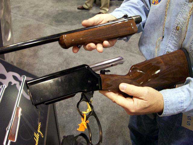

was just watching Dirty Harry (1971) (yeah yeah i know its a movie :) ).
the sniper, Scorpio, uses a takedown .30-06 sniper rifle.
i was wondering if this was a totally custom gun, just a movie prop, or if something like this actually exists:
a bolt action rifle with a removable barrel. ie: with one where the bolt head cams/locks into the barrel itself, like on a shotgun.
i took these screencaps from the movie to show you what i mean:
That was a custom rifle made up using a Japanese takedown paratrooper rifle as the starting point.
I think that rifle has appeared in a number of movies.
Doubt if it is the only such conversion around - there aren't too many bolt actions designed for takedown.
An unaltered paratroopers rifle would likely be worth somewhat more though. They are not particualrly common. I think that one is the second type, the first version used an interrupted thread system, not the wedge lock shown.
so basically unless you want to spend 4-5gs youre looking at (preferably a purpose-built takedown) Lever or hinge action?
something like a Browning BLR Lightweight takedown for $830 or H&R Ultra for around $330?
does the Ultra even takedown (it should, its a hinge action, but not every hinge action comes apart)?
has anyone owned either of these rifles? what were your impressions?
does anyone know of a place in Canada like SIR that stocks the BLR Takedown -- the pistol grip version shown above, not the '81. also interested in finding a place that sells the optional scout mount for them.
SIR mailorder sells only the '81 version of the BLR Takedown, with the straight grip stock and non-schnabel forend. ordinarily id go straight for the straight gripped lever but in this case i think the above looks like a nicer configuration.
i suppose the BLR would be the next best thing to a takedown bolt action, seeing as it basically *is* a modern bolt action rifle, with a lever operated bolt and box magazine. it would be even more compact than a bolt action.
