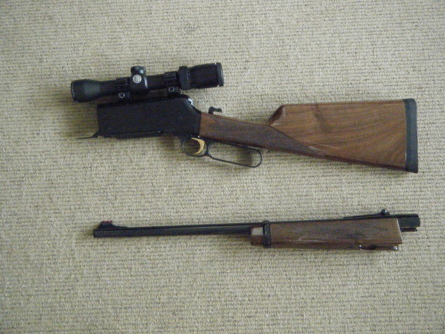

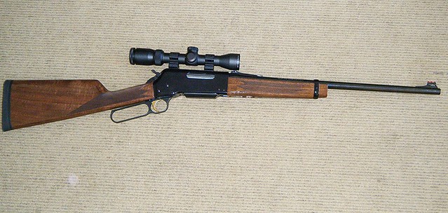

I have a take down BLR, it is I think easier to clean than the standard model, I am not sure if accuracy suffers, I use it with a Williams Fire Sight.
