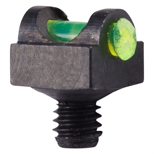

I have this on the way for my 870 from Brownells. For 5.55$ its worth a try... also ordered so Hi-Viz to try out.
I looked at a few different options and ended up going with the XS Big Dot. Not concerned about the Tritium, at least, isn't really a feature for me. It does provide a nice, easy to pick up aim point in any light conditions, though, and once installed, fits nice and clean against the barrel.
As far as "glueing" - I used Gorrila Glue 2-part epoxy, and the Big Dot "clipped" quite snugly onto the bead, the epoxy was under the category of "suspenders and a belt".
Thanks. That fibre optic one looks like it would get snagged a bit too easily. Guess I'll have to bite the bullet and order the big dot after all.

You can buy a pedestal from Brownells for cheap but then you have to silver solder it to the barrel or I guess you could try a metal epoxy of some sort.
It would allow you to try different beads.
