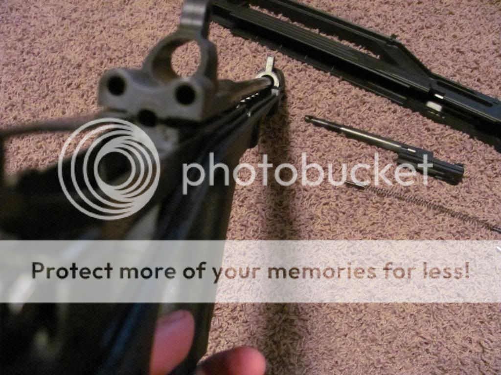

I added pics of both front and rear sights. Windage is adjusted on the rear sight, pretty easy to do. Elevation is adjusted with the front site. You remove the charging handle and it is the tool to adjust the sight. Compared to other firearms I have, they're functional but not great. My eyes aren't what they used to be so that doesn't help, I will be putting a red dot on it for sure. There are 3 pins to punch out to disassemble the gun for cleaning, or changing it for a left handed shooter. Not too complicated to break it down.

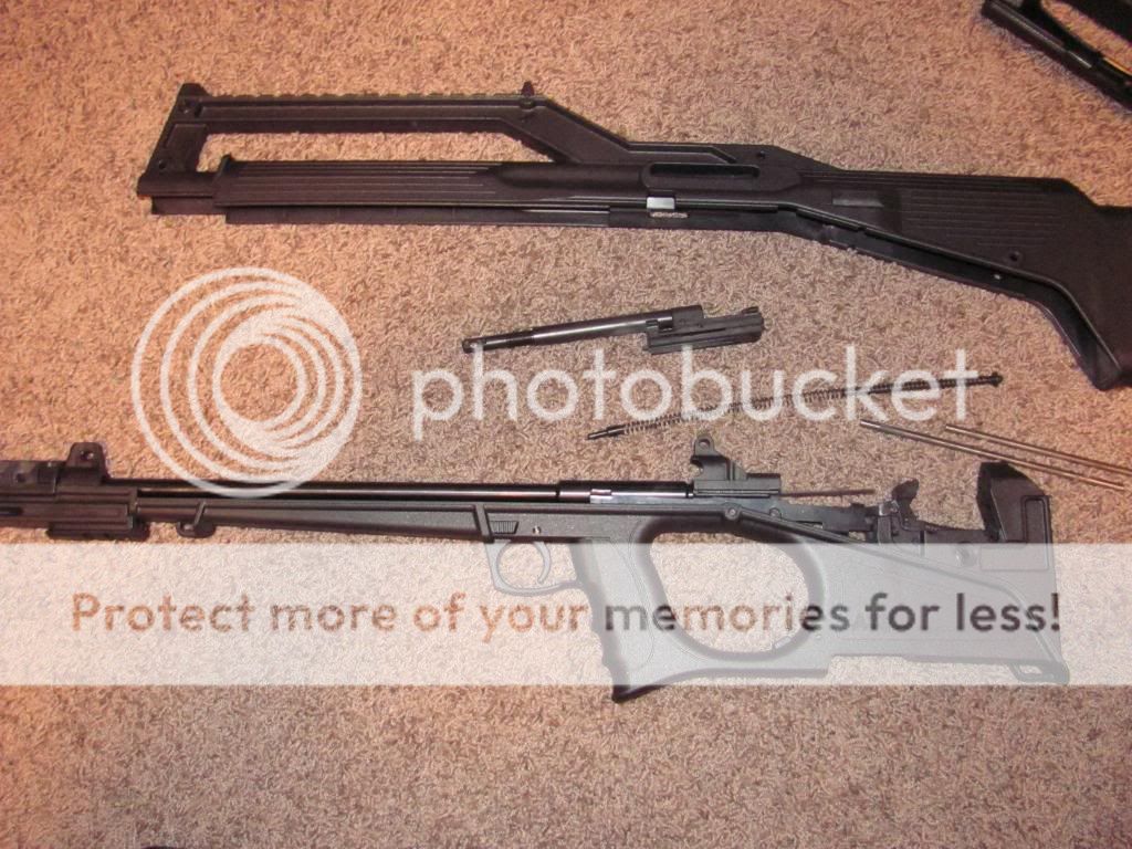

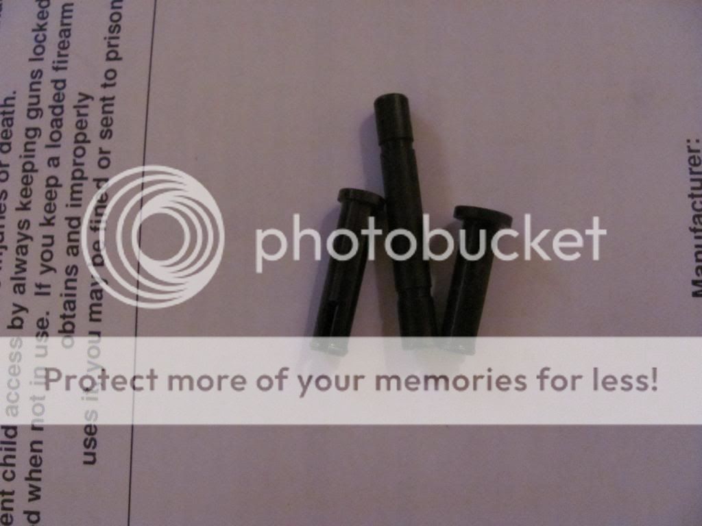

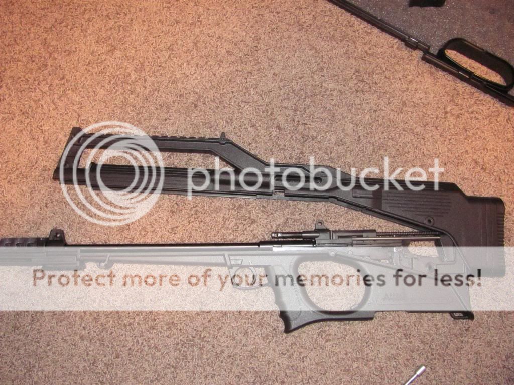

The first photo shows the 3 pins that need to be removed. Light pressure with a punch, no hammer required, took about 1 minute to do so. The upper shell is then lifted up as seen in the next photo. You can see location of the 3 pins in that pic. The 3rd photo shows the spring, guide rods and bolt removed, also very easy to do. Last photo isn't really clear but shows the barrel, easy access to clean. My first time breaking it down and took me less than 5 minutes. Took me less than that to reassemble.
