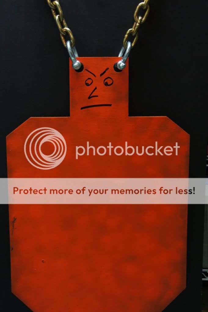

Also, if you want to have a bit of fun, cut two squares from the top, making an 8" square head. Paint angry face on it, commence headshots if you are a good enough shooter. :cool:

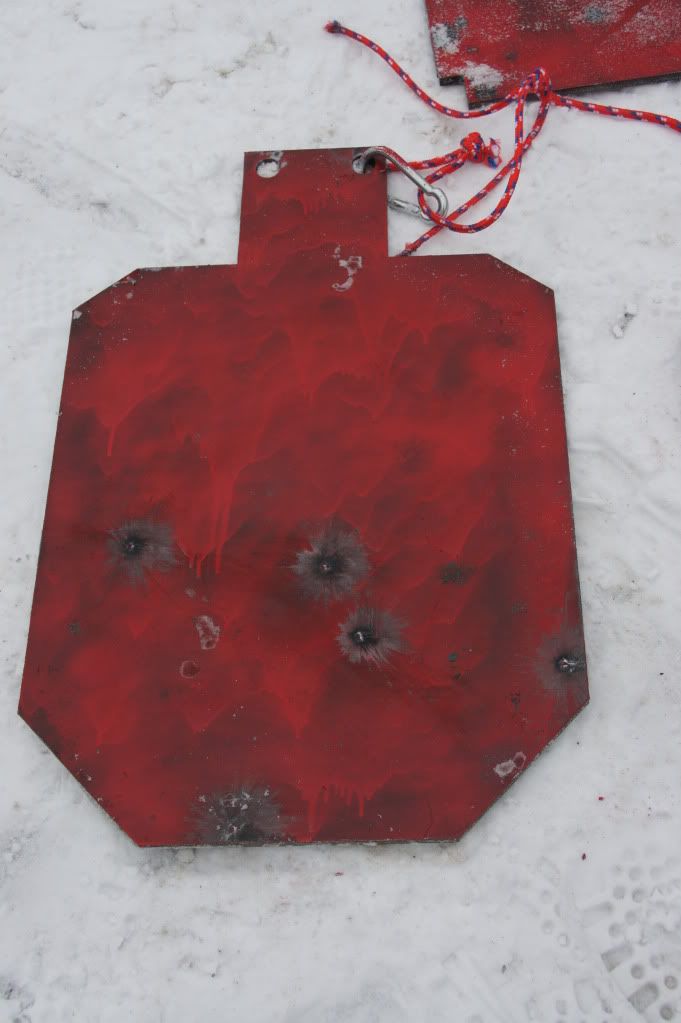

Use AR-500 if you can get a hold of it. The stuff is near indestructable. This is all a 50BMG does to it at every distance we fired at it from... peels the paint is is still smooth to the touch, not even a dimple or dent. Plasma cutting would be nessisary though...
Use 1/2" steel too, it will ring like a bell when hit, so you will know you hit even at extreme range. If you use heavy 3/4 or 1" stuff, you will only get a thud, which does not travel well back to your location, making it difficult to hear. Here is a vid I took of 1/2" AR500 on one of the above gongs.
