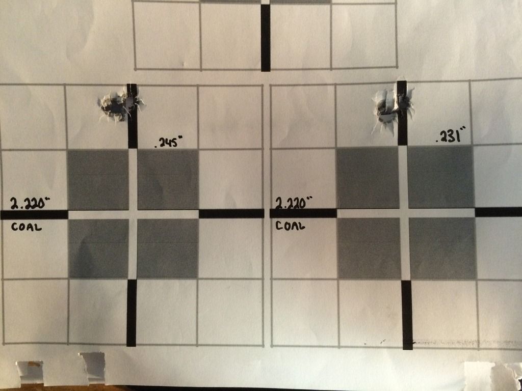

I just passed the 2000 round mark with this rifle...couldn't be happier...still easily shoots 5 shots into the .2s and .3s at 100 yrds when I do my part...last year at my first 300 yrd F Class comp I shot a "possible" with it. This thing makes me smile!
*** UPDATE ***
OK, I tried a new method of measuring distance to the lands...long story short, my measurements were a bit off from where I thought I was regarding bullet seating depth etc. I started tinkering around with COAL again and tweaked a load this rifle really likes.
155g SMK (#2155) 44.5g Varget - CCI BR-2 Primer - Seated .010 into the lands. (2.220" as measured on the Hornady comparator)
These are two 5 shot groups at 100 yards, both measure in the low ".2's"...both had 4 shot groups measure in the .04 to .03 range! HAPPY!!!
