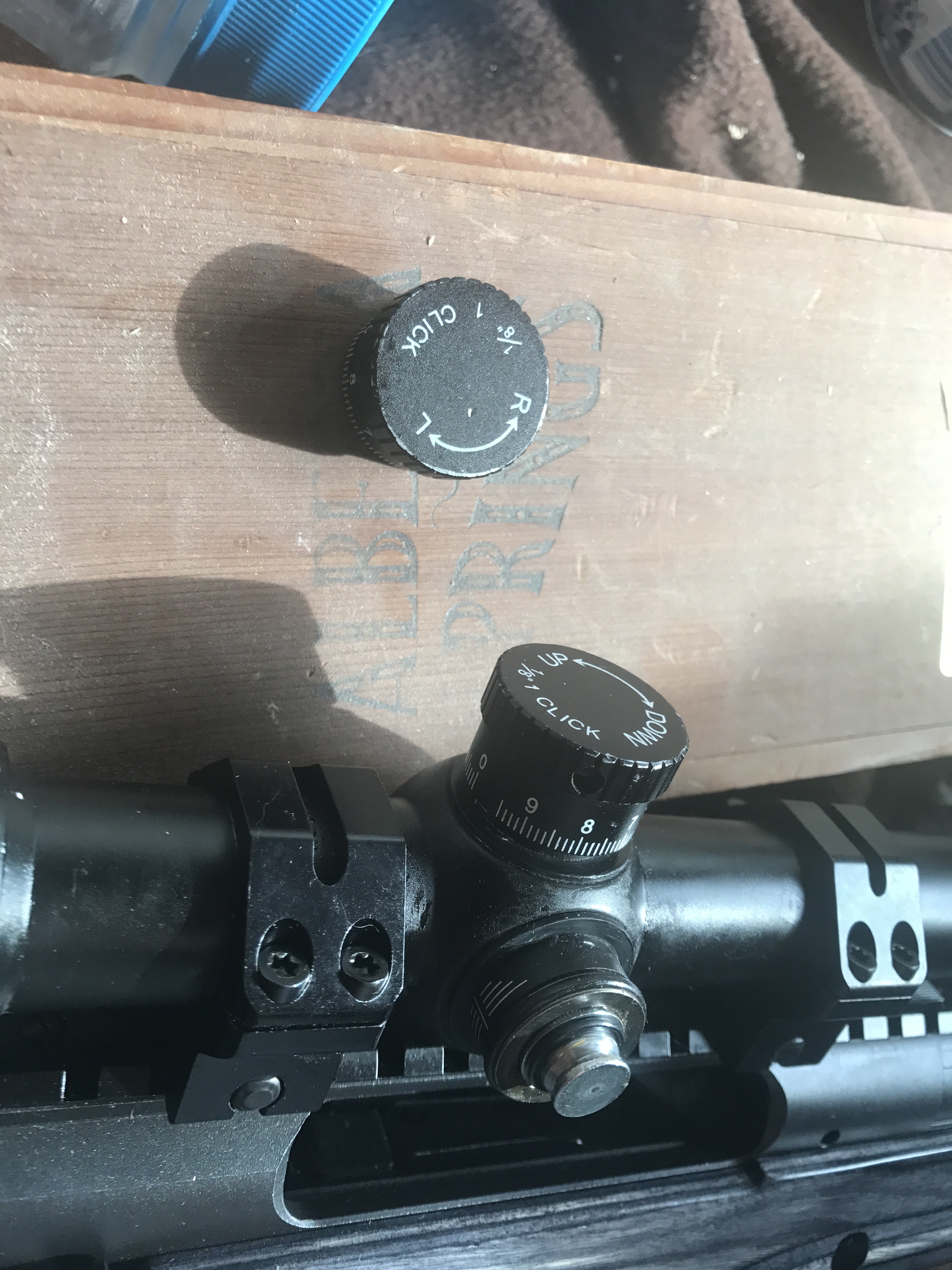

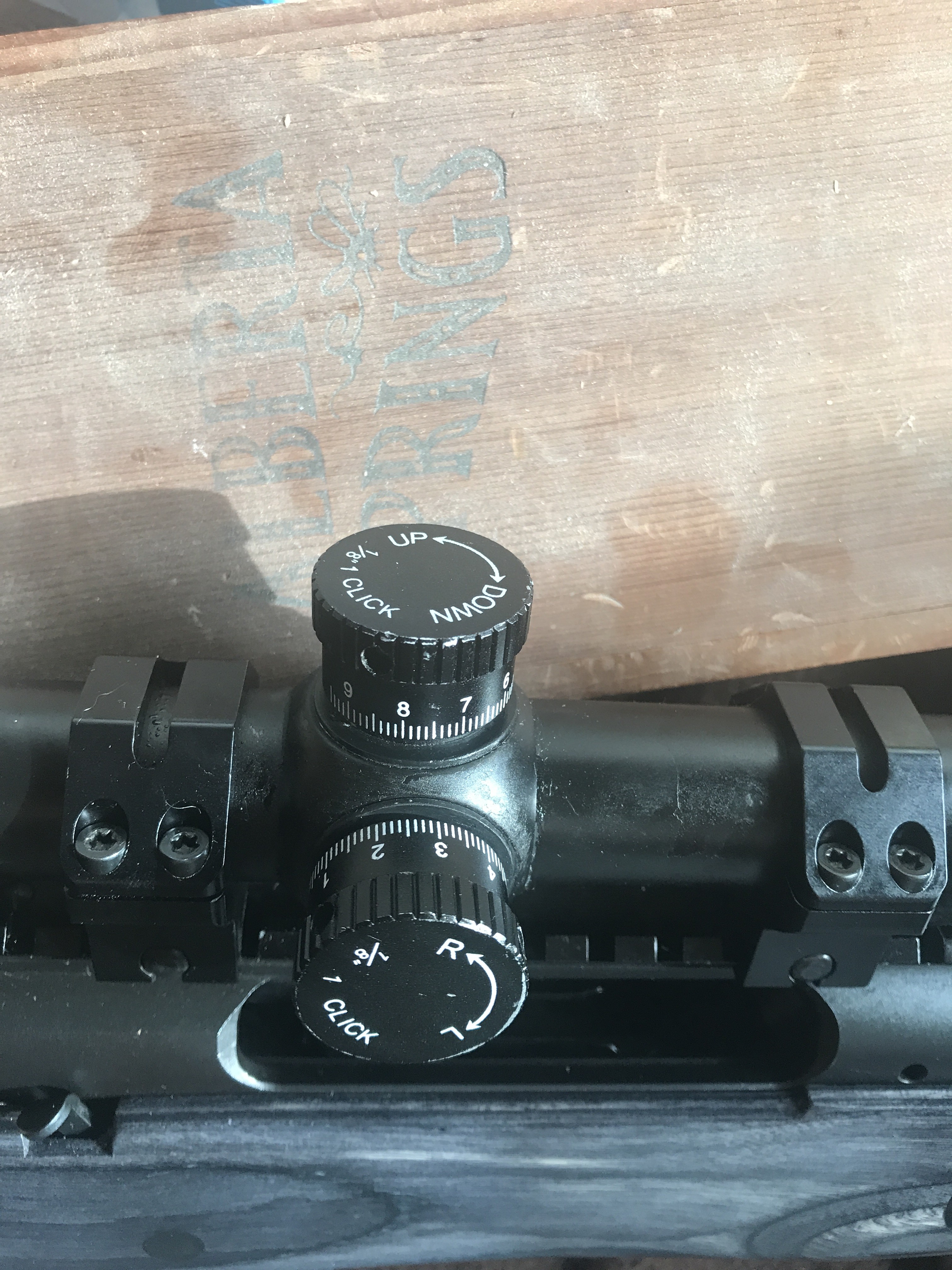

Why would you take the cover off? Sight in the rifle then loosen the 3 screws holding the cover on and and adjust to cover to 0 then tightens the 3 screws

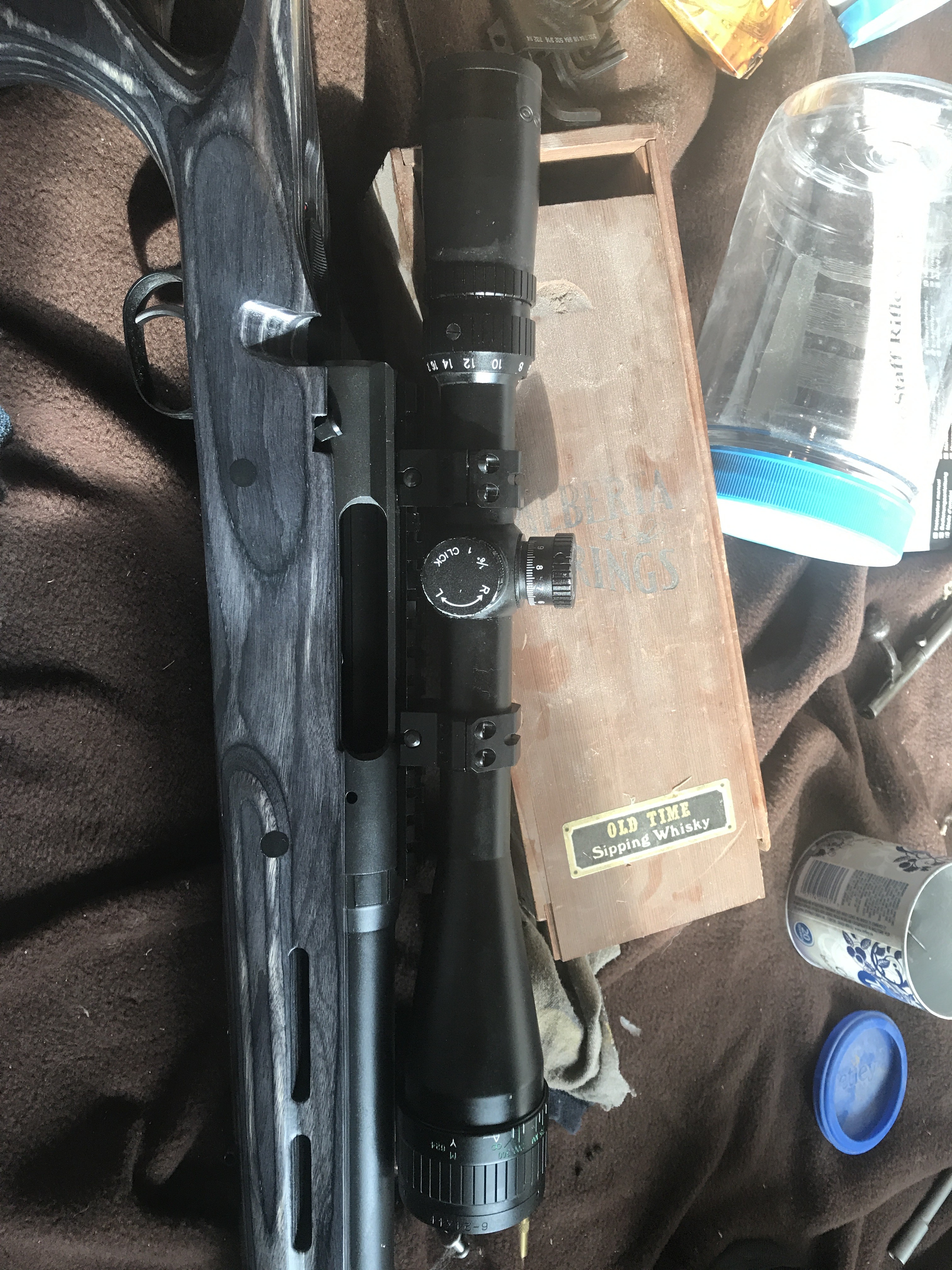

Tough scope to keep dialled in. Most of them with 1/8” clicks are preferred by BR or Silhouette shooters. I have one myself, and as a warning have to tell you that these scopes are meant more for target shooting than hunting use. Usually the AO is stiff, and the turret clicks are not what you would call firm.
Decent glass though![]()

I got this off another member it was covered in some kinda glue, I paid the shipping and if it works as it should I owe him $20.
So It's a great deal for a long range scope. It's going on a gun I will probably only use for sitting on the edge of a field
For coyotes.
