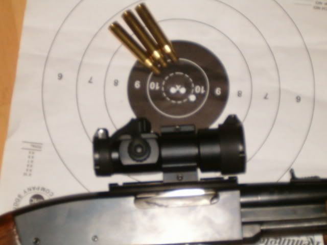

I finally got that tasco to the range. accuracy was pretty much what you'd expect for a 5moa dot. 6 inches at 100 yds from a rest and about 8 inches off hand. It would likely do better but my shoulder was hamburger by the time I got it dialed in. It seemed to be taking the recoil better than my shoulder with the original metal buttplate slapping me silly. I took three quick snap shots at 25 yds on the handgun range and was impressed with this group. I'll try it this year but I think I might have been happier with the bushnell 1x32.
It was easy to see when set at a higher setting like 8 (it was pretty sunny). The rifle is a .270 that is in need of a softer buttplate.
