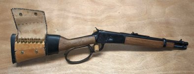

You don't have to cut it but, that depends on what works for her. I just heated mine and flattened out a bit. Made it better for me. Its easy and you can always cut it later. But as stated be for, more than one way to cycle the leaver, the wife cycles by grabbing the bottom of the loop. And putting a wrap on it makes it feel better.
Buds for comparison
