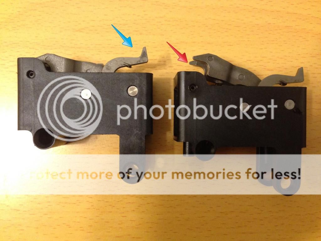

This Picture shows an example of the Canadian Trigger pack. The Canadian version has a release that is activated when the BCG is inserted. When activated, it moves the hammer to the cocked-ready position.
The American style trigger pack (borrowed picture) does not have this two-stage mechanism and in addition the BCG is different between the models.
You cannot use the Canadian Trigger with the 9mm Conversion kit! You must use an American SAR21 trigger or an aftermarket trigger. I opted for the Geiselle trigger, but have also obtained a US SAR-21 trigger pack that functions perfectly.

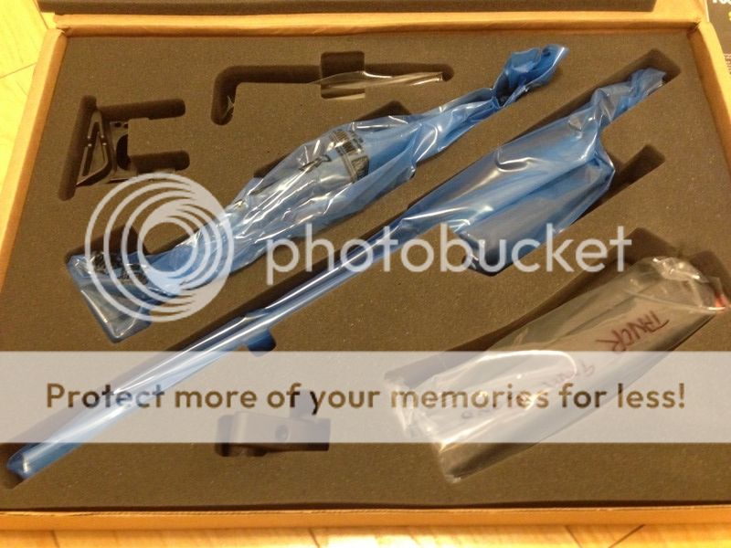

The 9mm Conversion Kit
Self-explanatory I think …. includes the BCG, Mag Adaptor, Mag (pinned to 5 rounds), Deflector ....
