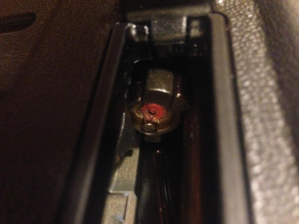

Just wanted to share my story and give you guys a heads up maybe save someone some grief . I used frog lube to clean my Tavor and Glock couple months ago and threw it back in the safe until yesterday when I took them both out for a trip to the range. Both guns have always run 100% until now! On the glock I was getting light strikes on the primers with all my ammo i was using 45acp from Norinco FMJ 230 grain and American eagle 230 grain FMJ and I would have 8 out of 10 rounds fail to fire ....as well with the Tavor it would short cycle the action(mfs 55 grain) Hornady super match 75 grain A MAX . The Frog lube turned into a sticky goo. After I stripped everything sprayed it down with my buddies CLP and wiped it off the next couple hundred rounds went off with out a hiccup. Needless to say I won't trust Frog lube anymore.

I could see how bad or no lube could cause the short stroking in the tavor (increased friction), but I don't see how light primer strikes could possibly be due to lubrication. You didn't stuff a wad of frog lube into the firing pin channel on your glock did you?

I bet that's exactly what happened, firing pin channel is likely full of Froglube.

On another note .... Even when some excess primer sealent? somehow ended up on the Tavor bolt face .... I still only had one round ever not go "boom" on the Tavor ....

The most frequent cause of light primer strike on a glock is gunk in the firing pin channel. It should be clean and dry. I don't use frog lube but your glock user manual show the precise spot where you need to apply lubrication. Stick with it and don't overlube it.
