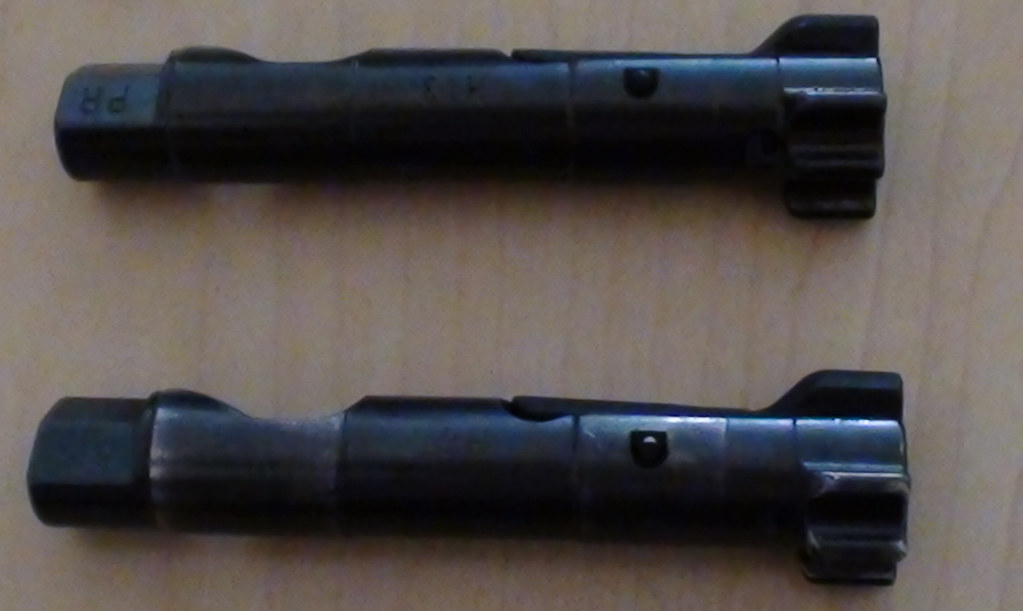

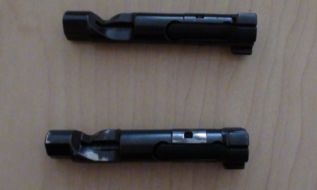

Is it possible the pmags damaged the bolt?, ive heard that on the scar and a few other non -AR type rifles, which includes the Tavor, that the pmags lift the bolt hold open which in turn, damages the bolt.....
Check to see if the bolt lugs have any "shiny" parts to them...aka: abnormal wear...
I think there is a thread about that...
Lol yes a thread I started.
Take a look, there are shiny parts on the mil bolt definitely.
I oiled everything super good, swapped the civ bolt in the for the military one, and filed any remaining roughness off of the P-mags.
Take a look at the bolts side by side:
We'll have to see how she performs during the mini-service-rifle shoot tomorrow morning!
