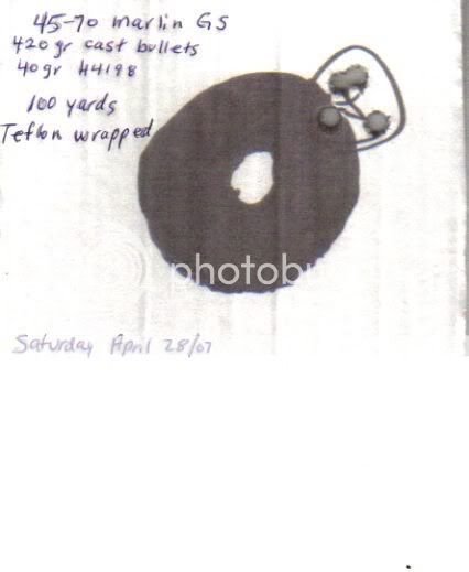

303carbine wanted me to post a picture of this group
These bullets were wrapped by HS4570,his seem to be a tad more accurate than when I wrap them.
I read up some more on the topic and it apparently makes a difference in which direction they are rolled out.
Twist them in the same direction of the rifle twist seems to get the best results.:sniper:
Nice group all right. What made you decide to teflon patch the bullets? I did cast for a friend's 45-70 at one time, but his gave good accuracy without patching. We may have come close, but I don't think we had a group quite this good. If memory serves we were using a 405 grain boolit. I know little about patching bullets myself, except what I've read from time to time and some of the comments made on the forum. Cheers! Fred

I heard about teflon patching from another board member and had him twist a few out for me ,as you can see it works very well. The teflon replaces the messy lube that you find on many of the cast bullets on the market. With the bullets teflon wrapped,there is no leading that often accompanies some cast bullets. Some will rant and rave and say it doesn't work, but the results are proof for me.
No voodoo or gimmicks involved,it works.
Are you going to hate me if I tell you that a lyman moly coated LBT 400 LFN doing 2000 FPS out of my marlin will shoot a group inside that group. If casting/lubing is done right leading is a non issue. My marlin,86 win etc never get cleaned even
PS typically from a scoped marlin at 100 meters

You got good results with your loads for sure,I would use that load because it works. I tried the teflon and found that it works too,despite the nay sayers.
No voodoo or gimmicks,it works and I'm not trying to flog a product by telling people it doesn't work.

X2 It's what works that counts and often different things work with different projectiles and different rifles. Sometimes there are more than two roads to the same place too. The last time I looked at cast boolit benchrest results the record was in the two's. They may be better now. I don't know. So, there have been better groups shot with cast than the first group displayed here. That doesn't detract from the fact that the first group is a good one and was shot with a patched boolit. fred
