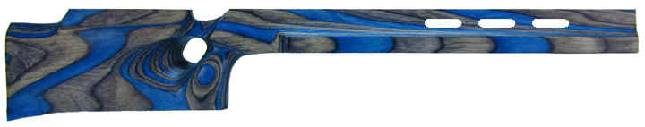

I'm not sure how much $$ you are willing to trow at this project... but on the low end of the scale, you could find a BRNO #3 or #4 and then have it fitted in proper target stock such as this
Richard's Microfit target gunstock can be had for as little as $120 depending on the wood grade/laminated you select.
If you want to spend more money, get and Anschutz of FWB barrel action. You'll gain a little accuracy and a much better trigger.

Silly.*, Thanks! I am sure Richard's has a gold plaque on the wall with my name on it. I am a huge fan of their stocks, and have given them pleanty of business. I am starting to make my own stocks now. I would like to know what sort of dyes they use in their laminates. I am experimenting with fabric dyes and they seem to work well.

if you want to closely match your F class rifle another alternative would be to by a Anshcutz barrelled action 1913 or 2013 and then get the above Richards stock.
You can save signifcant money buying a barrel action over the complete rifle as Anschutz stocks alone can put you over $5,00+ special 3p stocks. If your exclusive to F class the barrelled action with a stock similar to your favorite F class would give you exceptional training tool.
