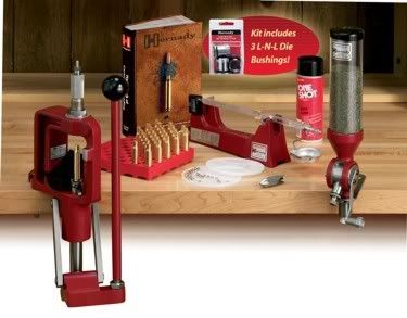

So would this be good for a newb to get started? Price is $463.99 from Cabelas
Product Description
Single stage reloading has never been simpler with Hornady’s Lock-N-Load Classic loader. It’s designed to make reloading quicker and give you the precision to create perfect, consistent loads round after round. The Lock-N-Load Classic reloading kit comes complete with the Lock-N-Load single stage press, three Lock-N-Load die bushings, Primer catcher, positive priming
system, and automatic primer feed. Also included is the 2 volume set of the 50th Anniversary Edition Handbook of Cartridge Reloading, magnetic scale, universal reloading block, chamfering and deburring tool, primer turning plate, unique case lube and Lock-N-Load powder measure.
