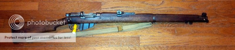

Tell me about this 1917 Lithgow SMLE
ninepointer
45   0   0
Central Ontario

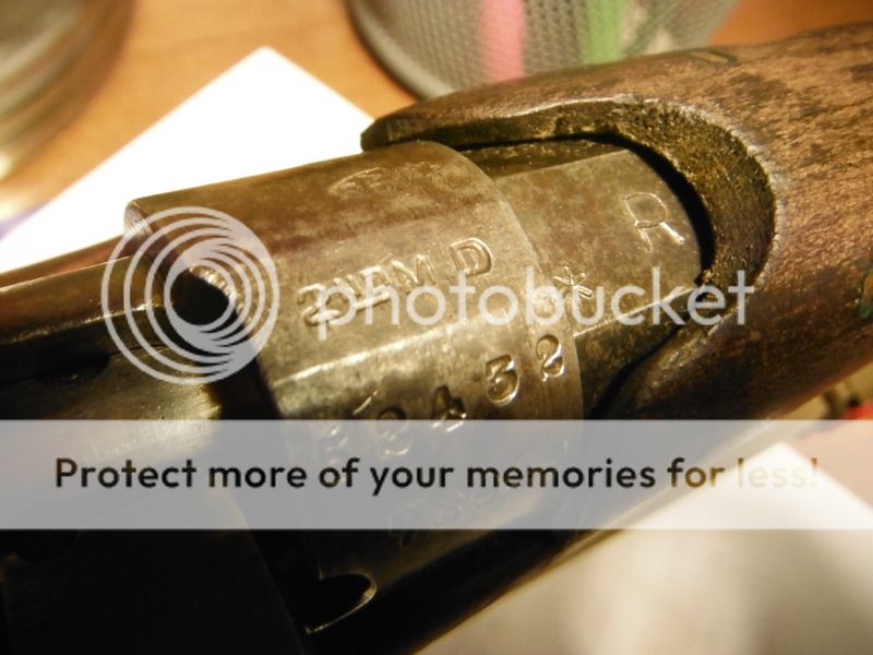

Having no previous experience with Lee Enfields, this one has been entrusted in my care. So far I have learned from the interweb that:
-Its a SMLE No. 1 Mk. III;
-Made in 1917 by Lithgow Small Arms, Australia;
-Used by the 2nd Military District (New South Wales);
-Stock is Queensland Maple.
What else can the Lee Enfield scholars here tell me about this one? Thanks!
It's a No.1 Mk. III no star, and has the mag cutoff.
Haven't time for more, but the asterix and large R on the knox indicate rusting in the barrel.

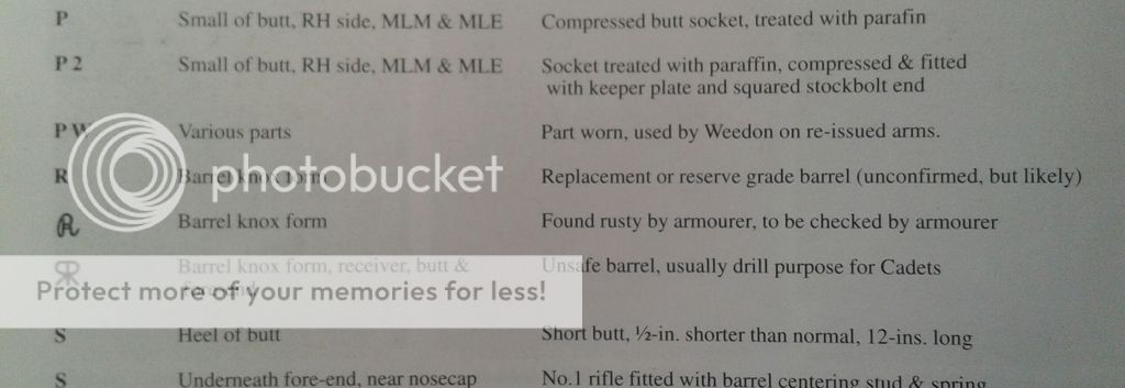

The second number that is on the top side is the inventory number applied when it was issued to the 2nd military district. The serial numbers were not lined out when inventory numbers were applied. I'm inclined to suggest the R on the barrel represents replacement barrel rather than rust because of the font style.

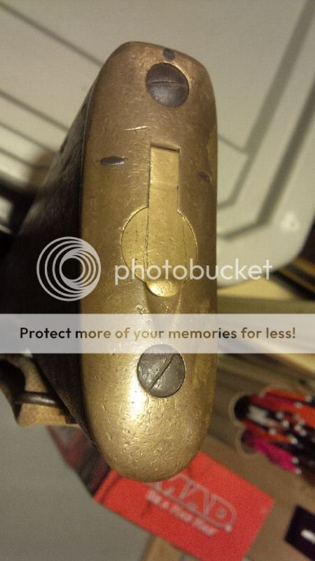

Readers might like to see a photo of the butt.
The asterix is another indication of rust, not just the R. I had a P14 with the same mark, and it too had rust. I agree that his inventory number wasn't lined out, but many are, and so was the one I owned and sold.
With Enfields, there always seem to be exceptions...

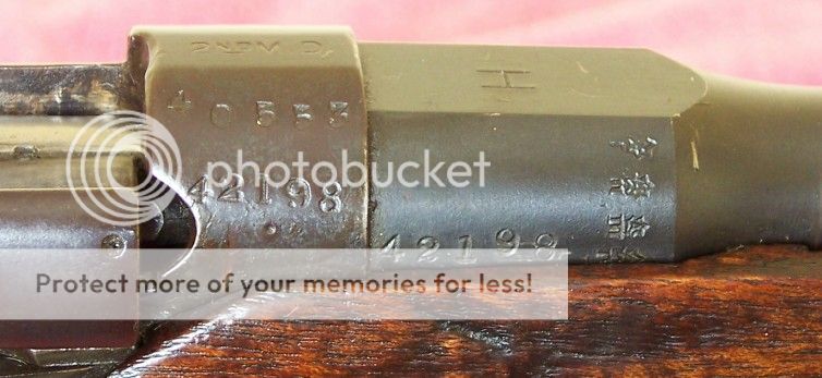

Steve no argument from me re the asterisk meaning rust in the barrel at one time, but the bold style R not.
Re the lined out numbers, I took from your previous post you were suggesting the serial numbers were lined out when the military district number were applied. Not so. Military district numbers were lined out/barred out, only when rifles were reallocated to another district, or sold from service.
5th Batt and HarryD: Ok, thinking back, the R on mine was the stylized R that 5thBatt posted above, under the regular capitol R. Also mine was not stamped, it was more of an "incision", ie, deeper than merely scratched in. So- I'm wrong again, lol.
And for the lined out numbers, yes, I was suggesting that the numbers were lined out when issued, as that is something I'd read more than once here and other places. Your explanation makes sense as to why some were lined out and others not. Thanks for the correction, always happy to learn something new.

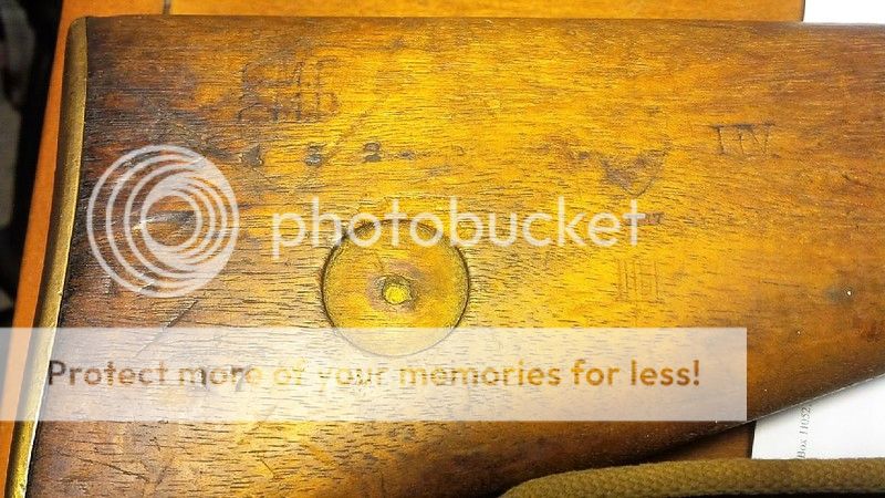

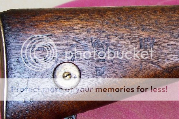

Thanks everyone, great info!
Here's a photo of the butt. What are we looking for?

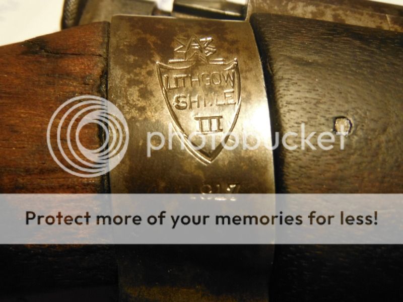

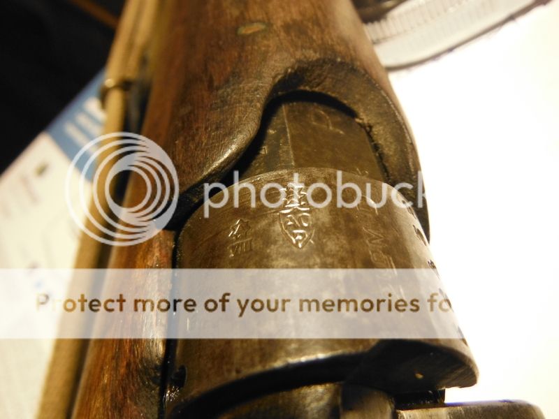

What do the marks on the right side of the receiver mean (stars, shield, Roman numerals)?
Is there a way of knowing if this gun saw war service outside of Australia?
That's the butt plate. A broadside shot of the butt would be better.
Roger that. Here it is:
The inventory number below "2MD" matches the receiver stamps, as does the Lithgow Shield 1917.
But there also is what appears to be 6MD (6th Military District, Tasmania) stamped on the butt.
Is "12/17" simply December 1917?
What else can be derived from the butt?
FYI, here's a good resource I've found regarding Lithgow marks: www.lithgowsafmuseum.org.au/factsheets/fs001_smle_markings.pdf, including:
* Slight pitting
** Moderate pitting
*** Bad pitting
