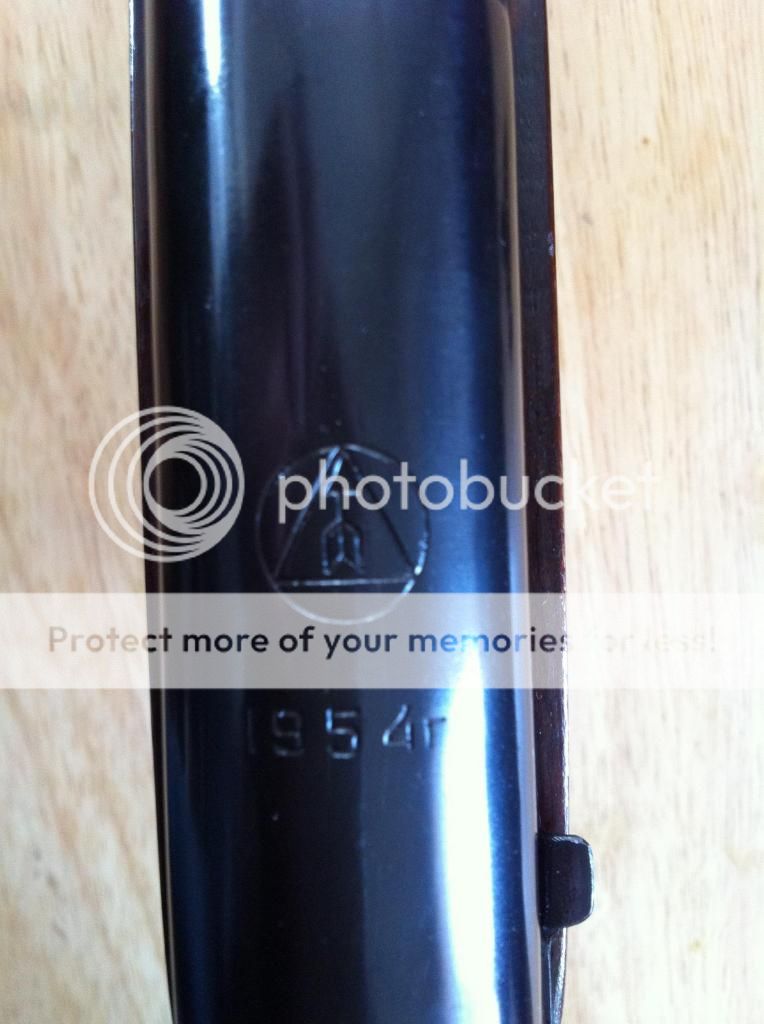

Telling difference between an Izzy and a Tula
Makers marks.
Tula is a star with an arrow inside.
Izhevsk is a triangle with an arrow inside.
Stamps will be on a lot of different parts, large ones on
Receiver cover and stock.
Izzy's were only made in 53 and 54. Any other year is Tula. There are 53 and 54 Tulas as well, see "CanadianARs" marking notes, or the sticky in the Red Rifle forum for detailed pics on the Russian SKS markings.

Izzy marking in receiver cover
