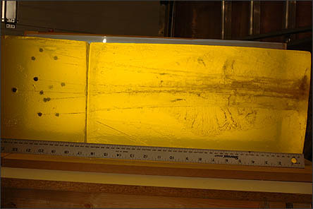

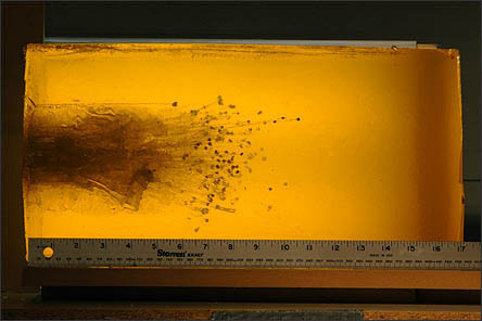

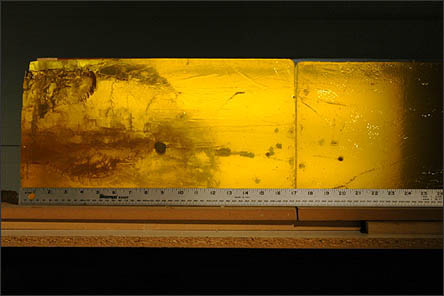

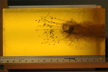

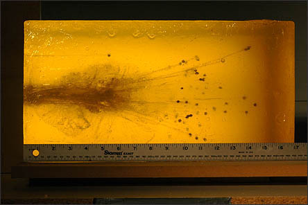

Like posted previously....it's pretty much irrelevant what the gelatin tests show.....as soon as ALL the pellets aren't on target buckshot of any configuration is very poor.
